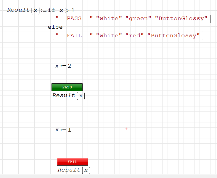

With some limitations, you can do that with this.
Thanks.
It works and maybe it will be enough.
But anyway, adding the ability to fomatted label would be great, then this definitely closed this issue

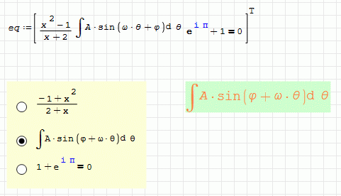

WroteSometimes you want the calculation to show by which formula the calculations were performed. Use for this combo boxlist is not beautiful. Formatted label would be more accurate. But Formatted Label does not display a formalized formula. Is it possible to add such a possibility to the formatted label? And in addition, the ability to remove the frame around the edges of the formatted label?

Formatted Label is superb for official document,
meets all demands. Maybe except for ComboBox.

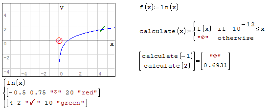

WroteI've really been getting some good use out of this plugin for pass/fail warnings on calcs, but here's a question. I tried using a check mark and X in an if statement in the label, and it displayed correctly in the if statement but not in the result. This was using the Segoe UI Symbol font. First I'd copied and pasted from Windows Character Map and the output was just the unicode number for that symbol. I went to Settings and changed the font to Segoe UI Symbol to see if that would help but it didn't. Is this something that is possible? Thanks!
Just released a fix, it should works now.

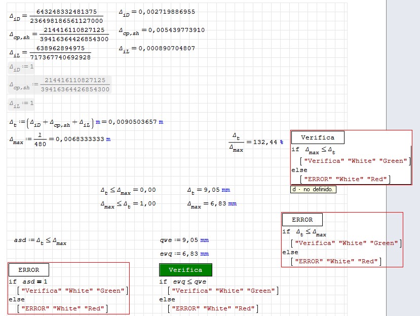

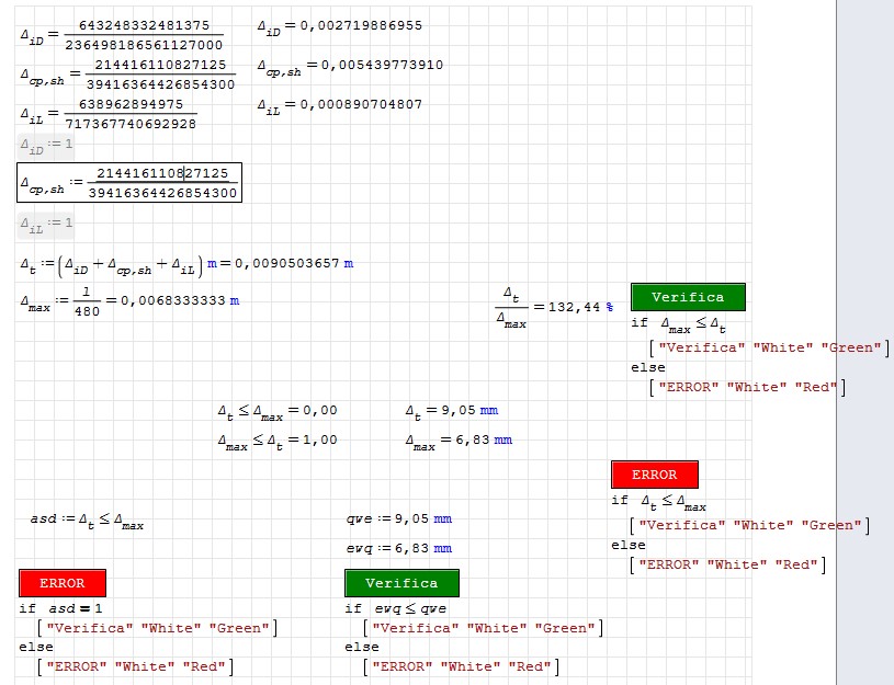

WroteHello, I am having problems with this plugin or I don't exactly know if the problem is the plugin.
Formatted Label supports conditional, providing set correctly.
