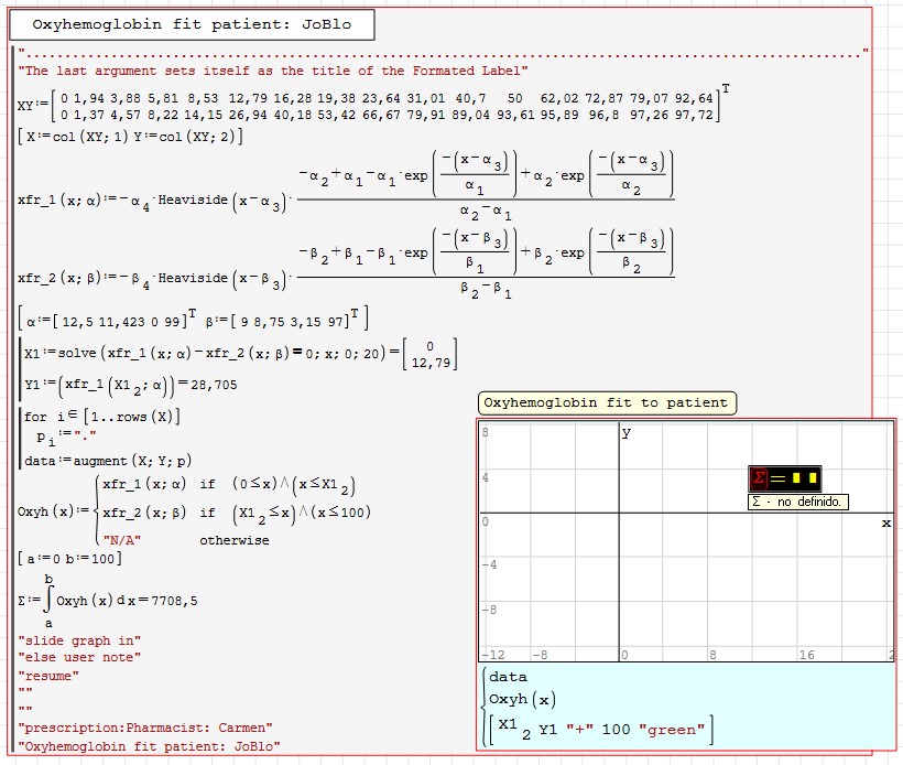

Sorry Jean but i don't understand what i'm supposed to see. I also get "data - not defined".

#83 Опубликовано: 17.01.2023 10:55:42
Here it is.
Document does not open ... incorrect format

#85 Опубликовано: 17.01.2023 11:20:05

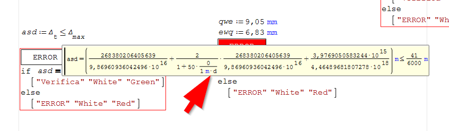

If you hover over the asd definition you can see that there is an unsolved "d" dependancy that triggers the error.
The same happens if you try to force a numerical evaluation using eval()
#86 Опубликовано: 17.01.2023 12:05:21
German
German
That is it!
As allways thanks!!
But still don't understand why Jean files fails.

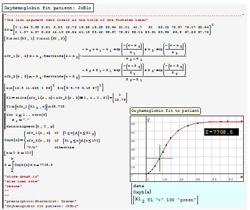

#87 Опубликовано: 17.01.2023 12:12:05
SMath Studio Desktop 64-bit
Version: 1.0(build: 8348)
Date: 9/11/2022
Slide left the Formatted Label
Side right the graph, remove the Σ no definido
You should see the plot.

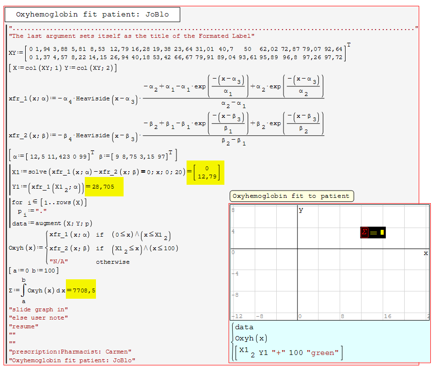

#88 Опубликовано: 17.01.2023 12:15:52
That is it!
As allways thanks!!
You're welcome!
There is an excel data import at the begin of the file, is not related to the issue however so it doesn't matter. nevermind I was looking at your file.
If you remove the 3 inline evaluations it will work.
2023-01-17 16_28_05-SMath Solver - [Image Formated LABEL [Oxyhemoglobin] FORUM.sm].png
#89 Опубликовано: 17.01.2023 12:39:57
German
German
My file can be an example of things NOT to do.

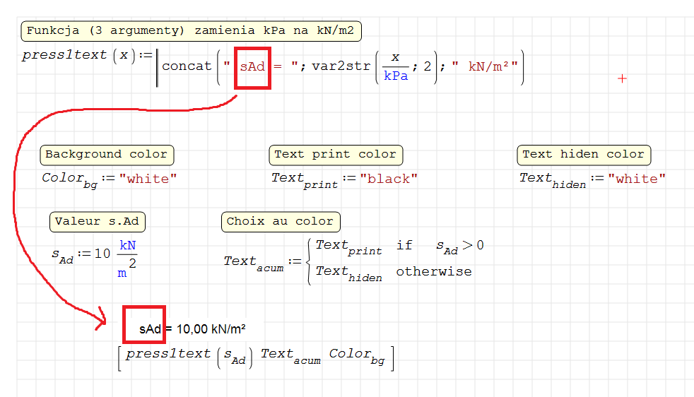

Can we manage the units that are displayed?
I have a load in kN/m2 and the result appears as kg/(m*s2).
The idea is to present only positive values (with the appropriate unit).
kind regards

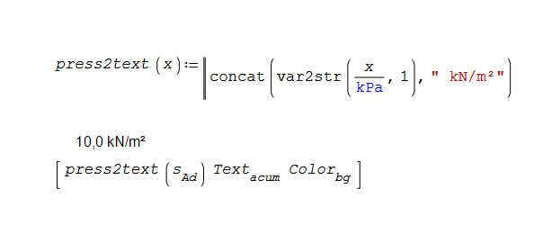

#91 Опубликовано: 14.10.2023 23:52:58
The easier way might be something like this
2023-10-14 18_53_23-SMath Solver - [Conditionally Formatted Labels_unity.sm_].png
press2text(x):line(concat(var2str(x/'kPa,1),"\0020\kN\002F\m\00B2\",1,1)
Oscar Campo 15.10.2023 00:41:00
#92 Опубликовано: 15.10.2023 00:08:06
Rogalski
Rogalski
Thank you very much.
This is exactly what I needed.

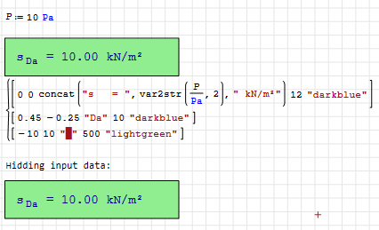

thanks for the information, but I'm not sure if I expressed myself correctly. I mean the subscripts in the "phrases" that I marked in the drawing.
Davide sent the function shown above in which I need to use subscripts.

#97 Опубликовано: 17.10.2023 13:30:37
Hi Karol. This could be a workaround, using the SMath Plot region.
label.sm (6,22 КиБ) скачан 1771 раз(а).
Oscar Campo 17.10.2023 16:52:00

#99 Опубликовано: 17.10.2023 23:23:29
Rogalski
Rogalski
Wow great Alvaro. Thank you very much.
I'm impressed.
