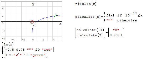

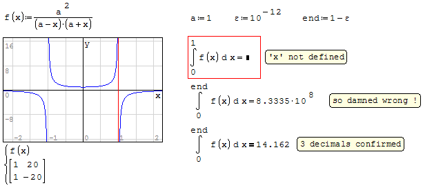

Sometimes you want the calculation to show by which formula the calculations were performed. Use for this combo boxlist is not beautiful. Formatted label would be more accurate. But Formatted Label does not display a formalized formula. Is it possible to add such a possibility to the formatted label? And in addition, the ability to remove the frame around the edges of the formatted label?
T
Formatted Label is superb for official document,
meets all demands. Maybe except for ComboBox.
I don't even know what ComboBox was invented for.
Done SS 6179 ... please report if red in your SS version.
The graph is done outside, on the RHS, then slided-in.
Image Formated LABEL [Oxyhemoglobin].sm (17.32 KiB) downloaded 1495 time(s).

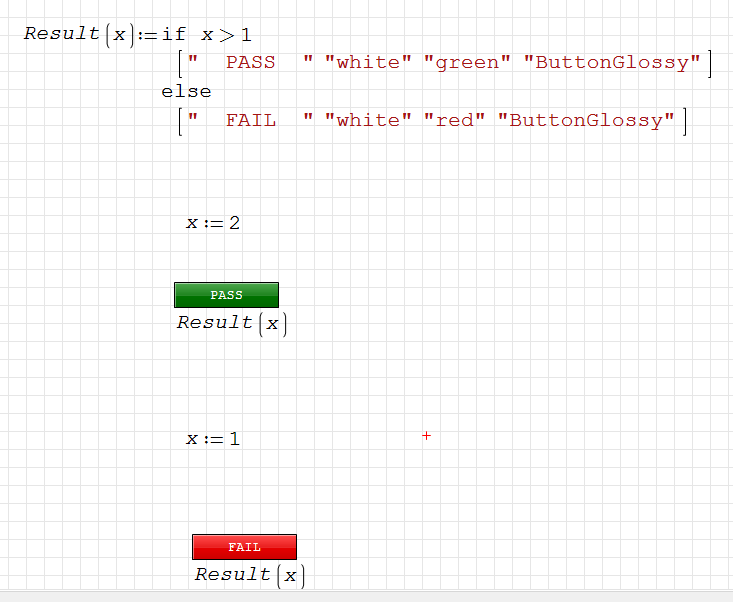

I've really been getting some good use out of this plugin for pass/fail warnings on calcs, but here's a question. I tried using a check mark and X in an if statement in the label, and it displayed correctly in the if statement but not in the result. This was using the Segoe UI Symbol font. First I'd copied and pasted from Windows Character Map and the output was just the unicode number for that symbol. I went to Settings and changed the font to Segoe UI Symbol to see if that would help but it didn't. Is this something that is possible? Thanks!
#67 Posted: 10/14/2020 8:47:18 AM
1,443 likes in 2,935 posts.
Thank you Jason, I think that I've missed to implement it in some branch of the code, I'll fix it ASAP.
#68 Posted: 10/14/2020 8:51:03 AM
About CharMap, you have to experiment several up until you get the
appropriate character instead of Unicode.
For direct calculations, Smath error message is sufficient.
You can't really trace from within program, not even Mathcad 11.
Calculations may have passed but so wrong !
#69 Posted: 10/14/2020 12:33:05 PM
Not sure what you are after ?
#70 Posted: 10/14/2020 8:15:48 PM
Just released a fix, it should works now.

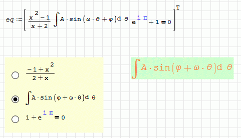

#72 Posted: 4/19/2021 11:09:42 AM
Claudio de Carvalho Aguiar
0 likes in 1 posts.
Hello everyone! I am new to SMATH and I am loving it... After reading thru this post, and experimenting with the plugin, I am still missing some instructions or user manual. I could achieve the following but I am not sure about the available options and maybe other features...733_602_1.png
#73 Posted: 4/19/2021 11:47:55 AM
Hello [userlink]ZehKraudio[/userlink],
the first post has an attachment (right above the picture) that conatains the documentation about this plugin.
Context menu (right click on the region) has the option to show or hide the border, as well as the link for the font dialog (that can be opened by double-click on the region).
Styles are listed in the documentation (I noticed it is a bit outdated, they are no longer case-sensitive).

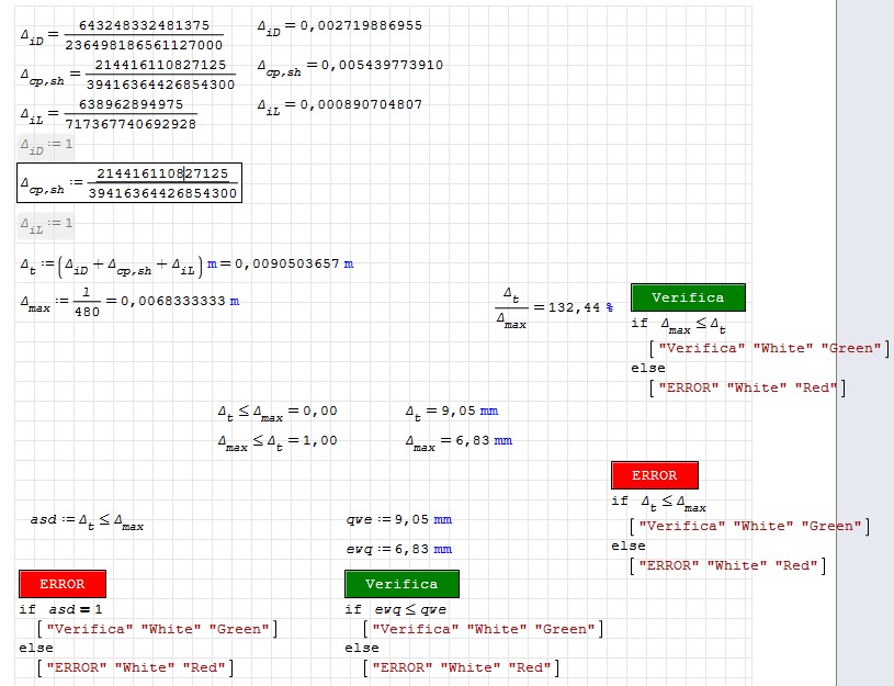

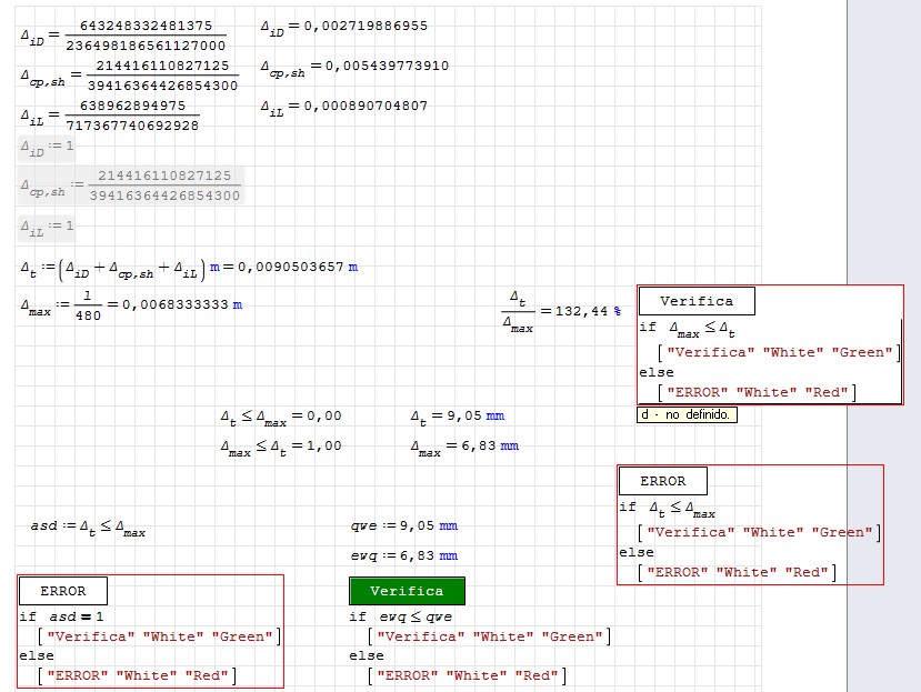

Hello, i am having problems with this plugin or i dont exactly kown if the problem is the plugin.
I attach images that can explain the situation better than my words.
When i define the same value manually the warning disappears
#79 Posted: 1/17/2023 12:14:36 AM
NDTM Amarasekera
NDTM Amarasekera
130 likes in 352 posts.
Hello. Better if you post the sm file, for anybody to check.
Davide Carpi 1/17/2023 11:21:00 AM
#80 Posted: 1/17/2023 8:42:51 AM
Hello, I am having problems with this plugin or I don't exactly know if the problem is the plugin.
Formatted Label supports conditional, providing set correctly.
Image Formated LABEL [Oxyhemoglobin] FORUM.sm (16.86 KiB) downloaded 1411 time(s).
