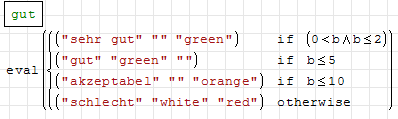

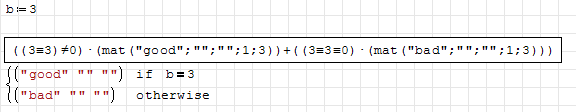

I would like to use cases because if you nest i.e. 10 if loops the code looks ugly. But cases seems not to work with conditionally formatted labels. Is there a nice looking workaround?
#43 Posted: 3/30/2015 10:42:47 AM
1,443 likes in 2,935 posts.
I'm from smartphone so I can't guarantee, but an eval(cases(...)) should works
#44 Posted: 3/30/2015 11:13:59 AM
brotjob
brotjob
7 likes in 71 posts.
works like a charm!

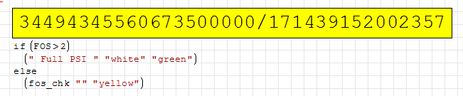

I am trying to create a label that displays " full psi " for a ratio greater than 2, but if the value drops below 2, it needs to display the actual value needed to maintain the ratio. I have it working except that it is stuck in symbolic format and displays an obscenely large fraction instead of the decimal value I need.
I have checked all of my formats and everything is in decimal and optimized to numeric. I have tried converting to a string with num2str and rounding the fraction to a decimal value.
Please help!
#46 Posted: 6/2/2015 3:43:01 PM
bAiLeY
bAiLeY
0 likes in 3 posts.
Thank you! This worked exactly like I needed to. And I agree, quite buggy.

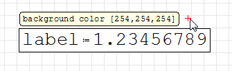

Would it be possible to add a button style to the Conditionally Formatted Label that had no black line border. The button style could be called "NoBorder" or something similar. I use the conditionally formatted label for displaying design checks as shown below
and I think it would be nice to not have the border around the equality sign (>).
Another possible use would be for repeating text in a header on multiple pages and not have borders around the text or quotes around the text if it is a string variable as shown below.
And if the background color could be set to transparent that would be crowning achievement.
Thanks for your consideration.

Would it be possible to add a button style to the Conditionally Formatted Label that had no black line border [...] And if the background color could be set to transparent
I think they are both feasible options
If the content is not related with calculation an option is even to use metadata content in fields objects of writer regions

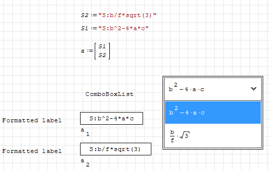

#59 Posted: 11/26/2019 3:41:57 AM
veb
veb
1 likes in 38 posts.
Hello!
Sometimes you want the calculation to show by which formula the calculations were performed. Use for this combo boxlist is not beautiful. Formatted label would be more accurate. But Formatted Label does not display a formalized formula. Is it possible to add such a possibility to the formatted label? And in addition, the ability to remove the frame around the edges of the formatted label?
Thanks in advance!
#60 Posted: 11/26/2019 4:30:29 AM
I think is not a problem 😉
