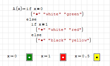

#3 Posted: 9/30/2013 12:30:11 PM
1,443 likes in 2,935 posts.
You're right Radovan, and you can also nest many if/else to have multiple outputs

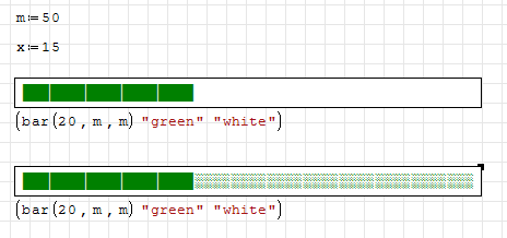

#5 Posted: 9/30/2013 2:12:09 PM
thanks Davide,
but I can't resize the label despite the presence of grip
Win64
Portable Version Smath 0.96 (build 4909)
The size is exclusively driven by the contents (string length). Might be a good idea to hide the grips.
Please find attached a brick for bar charts. Please note that I was forced to fill the right of the bar by visible symbols as spaces obviously are disregarded for computing the region size.
Example cfregion barchart.sm (4.95 KiB) downloaded 1976 time(s).
Radovan Omorjan 9/30/2013 2:51:00 PM
#6 Posted: 9/30/2013 2:39:22 PM
Correct, this is by design - like for hyperlink regions
I know, but is not yet possible; Andrey know this issue, the behavior will change in future
I can force the plugin to measure also the trailing spaces, if could be useful, just let me know it
best regards,
Davide
2013-09-30 20_38_18-SMath Studio Desktop - [Example cfregion barchart.sm].png
Radovan Omorjan 9/30/2013 2:52:00 PM
#7 Posted: 9/30/2013 3:04:25 PM
Done, updated
Martin Kraska 9/30/2013 3:23:00 PM

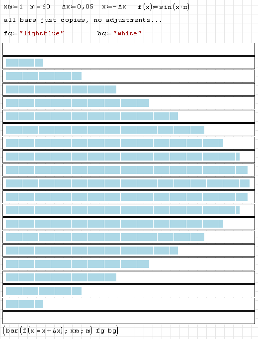

#8 Posted: 9/30/2013 3:38:42 PM
Now the complete bar chart.
Davide Carpi 9/30/2013 5:17:00 PM, Radovan Omorjan 10/1/2013 4:46:00 AM

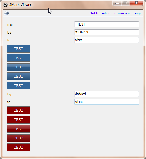

#16 Posted: 10/25/2013 11:39:06 AM
UPDATED
- small fixes
- added styles (optional 4th argument)
Andrey Ivashov 10/26/2013 8:22:00 AM
