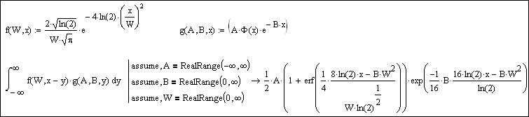

#1 Опубликовано: 01.10.2018 08:55:22
Just confusing it does not evaluate correct Φ(0)=0.5
Bug Heaviside.sm (10,27 КиБ) скачан 1147 раз(а).

#3 Опубликовано: 03.10.2018 12:58:26
Thanks Alvaro.
True: only Mathcad recognizes Heaviside as a function
However, Smath proceeds the convolution integral alright.
Convolution Numerical [WORKING model].sm (33,32 КиБ) скачан 932 раз(а).
Convolution Numerical [Unsolved MCD] Copy.sm (243,32 КиБ) скачан 988 раз(а).
