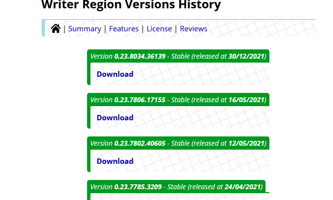

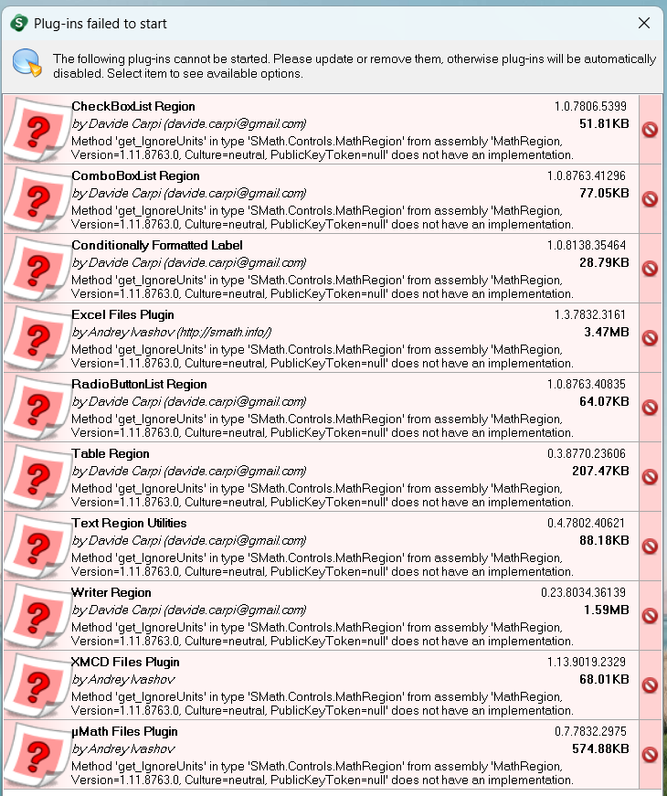

Since the extensions manager is no longer available for older versions, you have to download and install the plugins manually (downlad the zip, the drag & drop in the canvas), going back to an appropriate release date.
The link to download any plugin version is this:

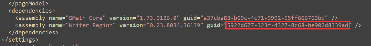

https://smath.info/{LOCALIZATION}/view/{PLUGIN_ID}/historyPlugins' IDs can be found in the heaader of any worksheet where you used it (using a text editor). Localization is the one that is visible in your browser when you browse the forum.
