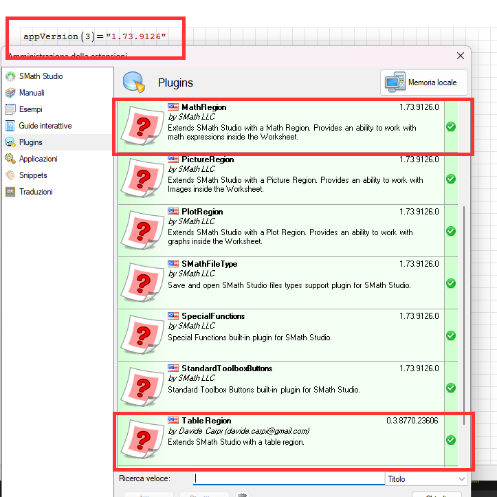

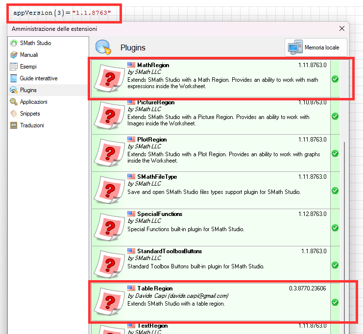

Since with these versions you can rely on the Gallery, I suggest you to:
  1. Make a copy of the "extensions\plugins" subfolder in your portable app directory
  2. delete that plugins subfolder
  3. install the plugins from the gallery again
Отредактировано 25.03.2026 09:47:18
