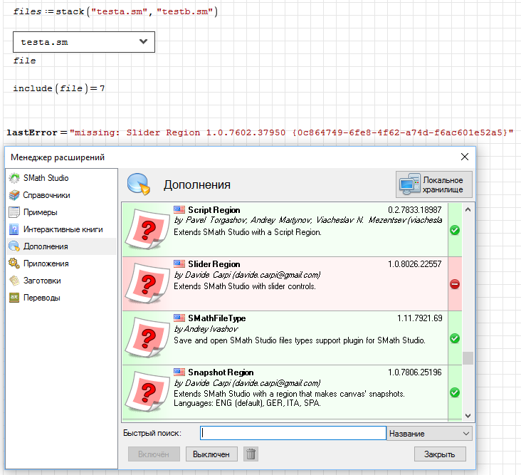

Changes:
- added support for: numericupdown, pathpicker, mathcad block, script;
- lastError shows missing plugins for the last included file (function compares the dependencies of the include file with the current set of enabled plugins).

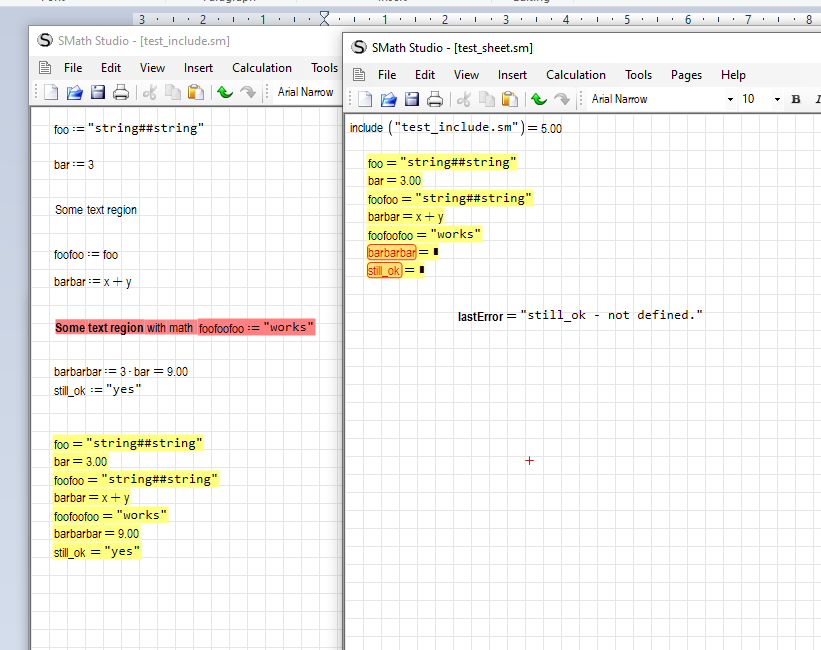

Hi uni,
Thanks for the new updates. I found a bug. If I have a text region that has a formula, formulas after it will not be included.
test_sheet.sm (4,39 КиБ) скачан 1550 раз(а).
test_include.sm (6,79 КиБ) скачан 1601 раз(а).

#144 Опубликовано: 19.02.2022 15:02:12
SMath Studio compatibility
Plugin updated. For now I don't know how to parse math equations inside text region correctly.
Changes:
- text region partially supported.
Chito 19.02.2022 19:31:00
