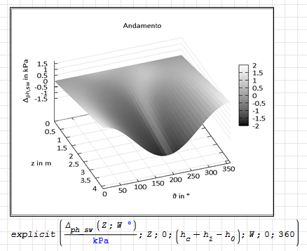

I've got a problem with a 3D plot function.
The function is very simple but i'm not able to find the correct syntax for plot it.
Someone can kindly help me with some advising?
Thancks in advance, i attacched below the Smath reference file where i had higlighted with an arrow the function.

For instructions on Maxima plots see https://doi.org/10.25933/opus4-2949
Note that the dummy variables need to be undefined in the sheet.
![2023-11-29 01_22_29-SMath Solver - [Azioni_Sismiche_Silo_D1101.sm_].png](/ru-RU/files/Download/sySLTQ/2023-11-29-01_22_29-SMath-Solver---[Azioni_Sismiche_Silo_D1101.sm_].png)

Very easy to get the two circles ... one being shifted.
Tip about X_Y plot ... as soon as you open, give a title.
Next manipulation, click on title.
That technique will save from freaking X,Y ranges.
Jean.

WroteI've got a problem with a 3D plot function.
The document from Martin does not work for me.
At this point of the project, if you can attach the matrix,
I may try to render the gray image in RGB.
I have the RGB mapping codes associated with the vectorise code.
Not so sure ... your matrix is huge 360 cols !
