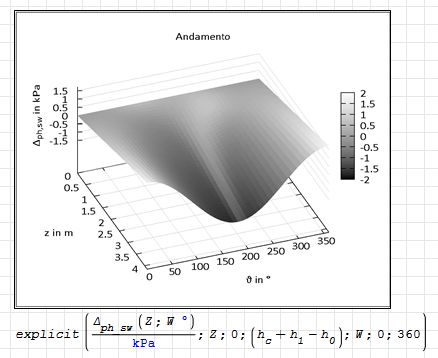

I've got a problem with a 3D plot function.
The function is very simple but i'm not able to find the correct syntax for plot it.
Someone can kindly help me with some advising?
Thancks in advance, i attacched below the Smath reference file where i had higlighted with an arrow the function.
#2 Опубликовано: 29.11.2023 08:26:12
For instructions on Maxima plots see https://doi.org/10.25933/opus4-2949
Note that the dummy variables need to be undefined in the sheet.
Azioni_Sismiche_Silo_D1101_Kr.sm (1,2 МиБ) скачан 1532 раз(а).

Very easy to get the two circles ... one being shifted.
Tip about X_Y plot ... as soon as you open, give a title.
Next manipulation, click on title.
That technique will save from freaking X,Y ranges.
Jean.
