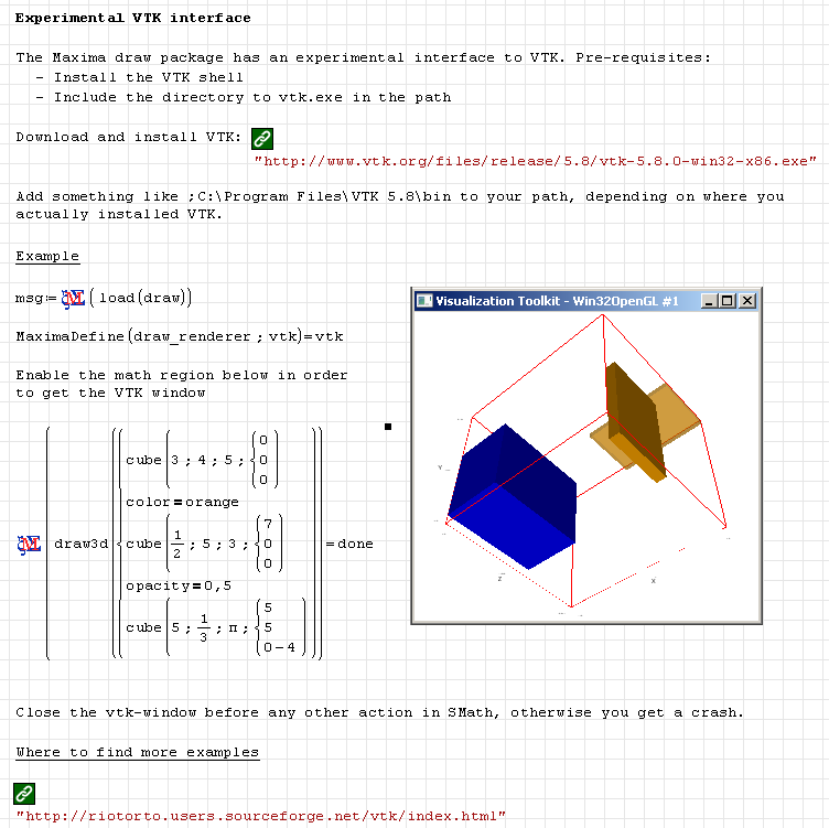

#63 Опубликовано: 03.08.2014 07:45:44
The Maxima draw package has an experimental interface to the VTK visualization toolkit. It provides high performance 3D rendering.
Objects and options are very similar to those of the Gnuplot interface in the commands Draw2D() and Draw3D().
The current state of the Maxima plugin allows you to play around with VTK. Some limitations apply:
- The interactive viewer is opened as a separate window (not embedded in the sheet)
- The Maxima plugin does not wait for the viewer to be closed but gives up after some short time.
- Any SMath action while the viewer is open can generate a crash.

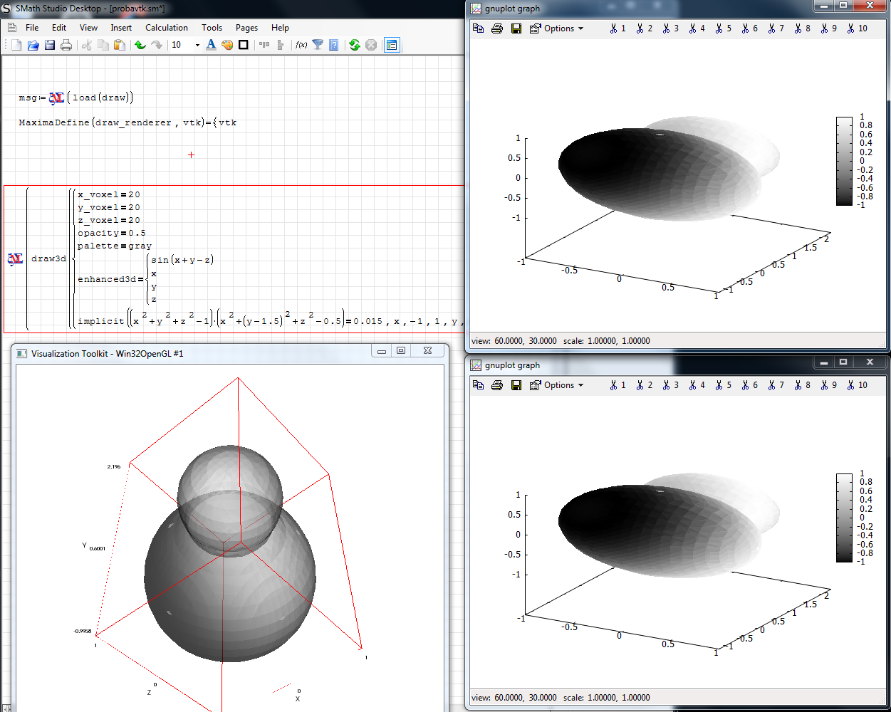

#65 Опубликовано: 03.08.2014 11:24:12
Thank you Martin with keeping this up
I just played a bit (see the picture, please). I suppose this will be improved and I wish you all the best of luck in your efforts.
In the case I did not do something wrong here, but it seems that my example produces additional gnuplot windows.
probavtk.sm (5,7 КиБ) скачан 1445 раз(а).
#66 Опубликовано: 04.08.2014 15:53:01
This is related to issue SS-189. Maxima is restarted and the plugin retries to execute the command. However, in the new Maxima process, the variable draw_renderer has the default value (gnuplot) instead of VTK.

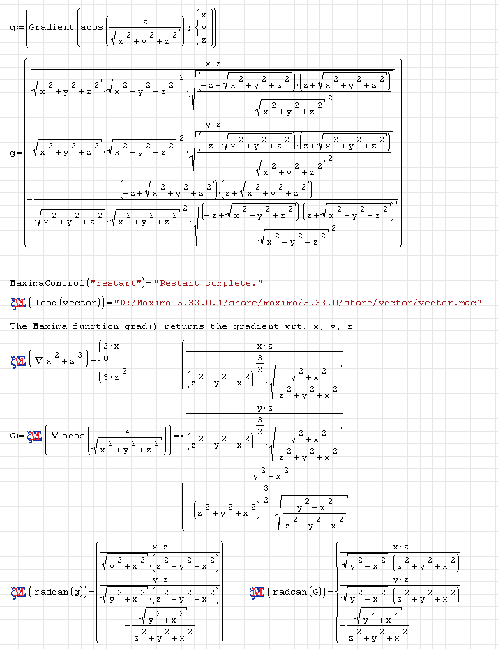

#68 Опубликовано: 25.08.2014 17:25:27
Here comes life to the gradient symbol of the functions extensions plugin.

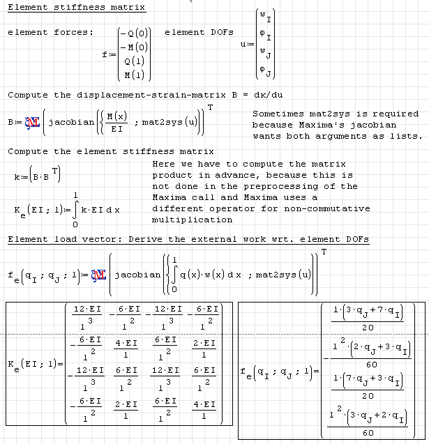

#69 Опубликовано: 15.09.2014 09:11:34
In the attached sheet you find the construction of the element stiffness matrix and the element load vector for a shear-stiff plane horizontal beam finite element as used in this example.

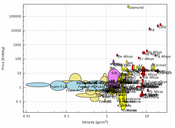

#71 Опубликовано: 18.01.2017 13:00:15
This example produces Asby material property charts. The data has been taken from the online ressources for Buchmayr 2002. Besides the Maxima plugin and it's drawing functions this program also demonstrates the use of varous plugins by Davide (ComboBox List, DataExchange, Checkbutton List)
It was posted already 3 years ago, works with the current SMath+Maxima version (no symbolics involved). Just cosmetic changes (output as PNG instead of SVG)
