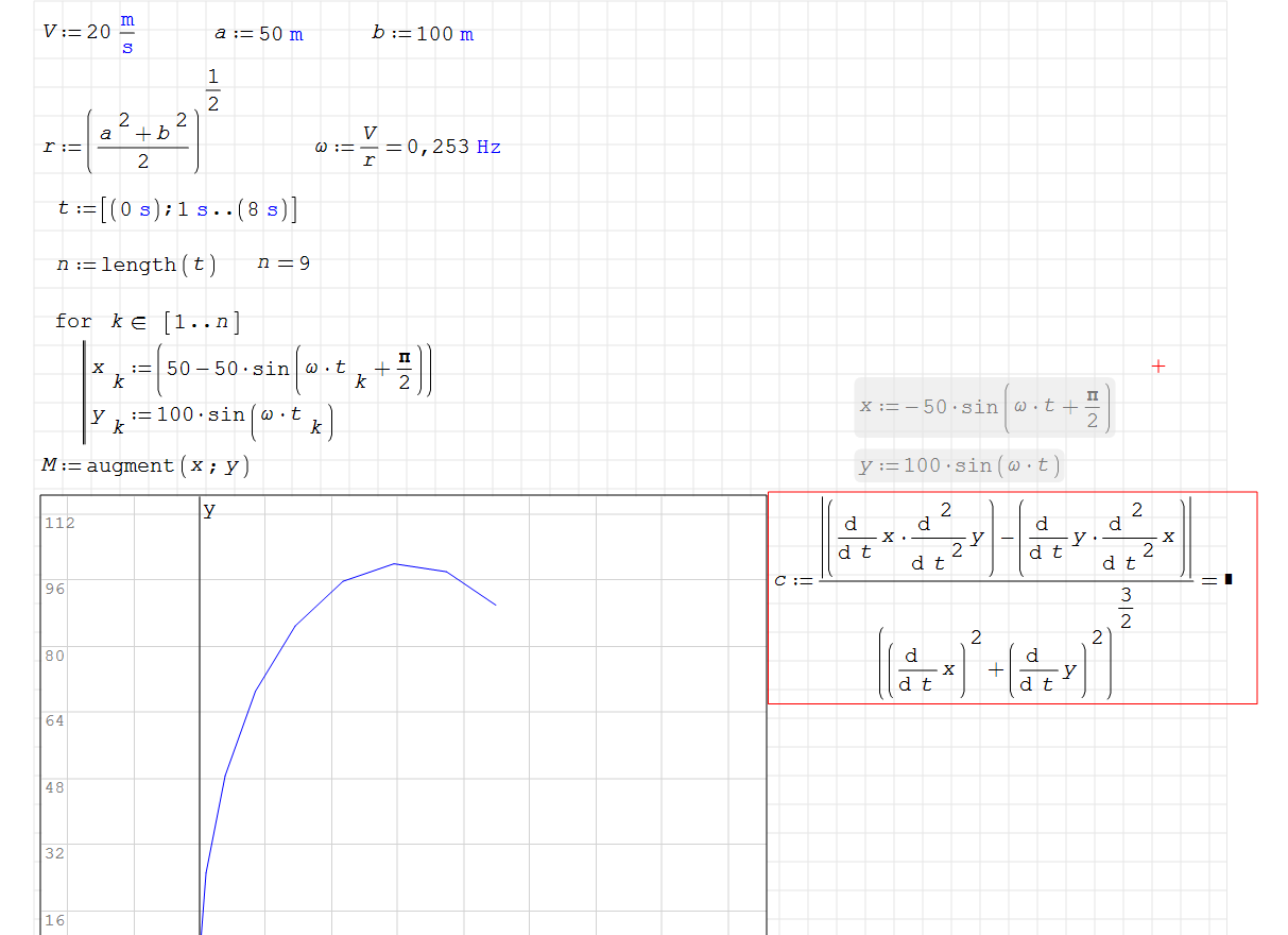

Hello everyone!
I have difficulty plotting the function c which depends on the derivatives of two functions which in turn depend on the parameter t.
Could anyone help me? This in the smath file.. curvatura.sm (11,36 КиБ) скачан 1532 раз(а).
Thank you so much

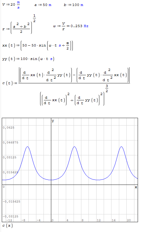

Hello everyone!
I have difficulty plotting the function c which depends on the derivatives of two functions which in turn depend on the parameter t...
Maybe this is what you want...
... and the .sm file: curvatura1.sm (9,4 КиБ) скачан 1595 раз(а).

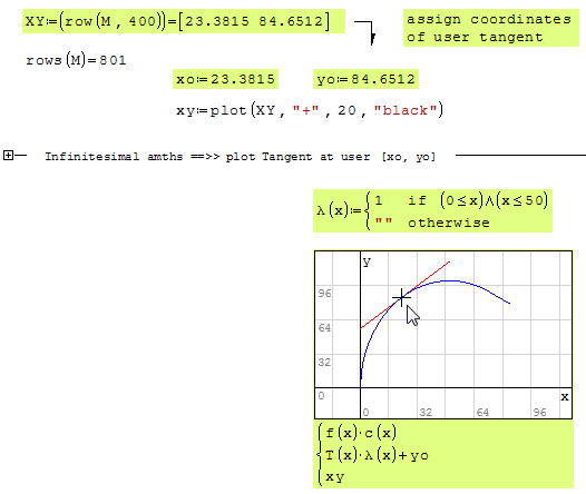

How can I draw the tangent line to the equation in parametric form?
this is the file … curvatura2.sm (12,5 КиБ) скачан 1632 раз(а).

Hi Ale. Here, some ways.
curvatura3.sm (25,1 КиБ) скачан 1594 раз(а).
curvatura4.sm (20,83 КиБ) скачан 1583 раз(а).

#8 Опубликовано: 06.12.2019 13:08:58
Thank you very much for the availability.
But I need more help.
For the Tangent over C(t), it will follow the scalar rules
of the document Tangent.sm posted before.
The Tangent over the parabola is another business.
Smath does not derive linterp(x) as it is NOT a function
only an interpolation. This project and lot more are
rescued via Infinitesimal Analysis [dates back before CAS].
For that particular typical user point of tangency, OK.
You may want to experiment more .
Don't mind to see noisy curvature [disabled in collapsed].
Chers ... Jean.
curvatura2 Copy.sm (30,56 КиБ) скачан 1567 раз(а).

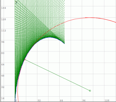

But if I wanted to find the tangent to the curve when the parameter t changes, how should I do?

Thanks for the answers.
Do you mean the envelope, all the tangents for the range en T?
curvatura5 - envelope.sm (23,64 КиБ) скачан 1475 раз(а).
