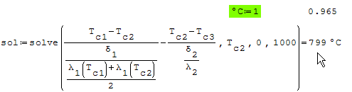

#1 Опубликовано: 22.05.2023 07:30:56
Valery Ochkov
Valery Ochkov
Why no solution?
Units?
Krasnoshchekov-Sukomel-10-10.sm (203,8 КиБ) скачан 1381 раз(а).

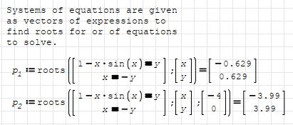

#4 Опубликовано: 22.05.2023 10:11:59
root is undocumented in Smath. However, we have applications.
Solve Inverse [Seeded Scanner QUICK TRACK] Copy.sm (150,91 КиБ) скачан 1143 раз(а).

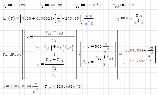

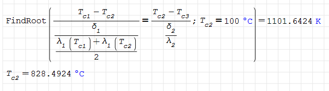

#5 Опубликовано: 22.05.2023 12:51:11
Use Findroot() for solving with units.
And your λ.2 part was different from original document.

#7 Опубликовано: 22.05.2023 17:55:55
Send please the SMath file!
Krasnoshchekov-Sukomel-10-10_findroot.sm (206,95 КиБ) скачан 1373 раз(а).

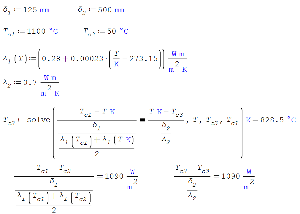

Solution from Alan Stevens
Krasnoshchekov-Sukomel-Alan.sm (206,24 КиБ) скачан 1350 раз(а).
#9 Опубликовано: 23.05.2023 09:34:25
Brilliant solution ... Thanks Valery

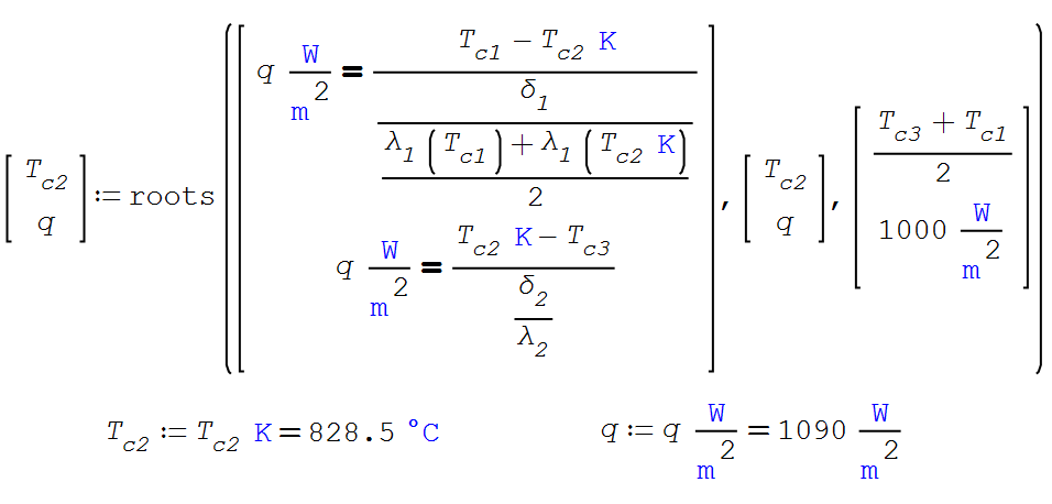

#12 Опубликовано: 23.05.2023 11:05:22
Can we do it with the Roots function with 2 or more equations and unknowns?
Yes you can.
With inserting units, roots() can solve as solve() function.
roots() and Findroot() are both capable of solving system of equations.
Findroot() can solve without inserting units.

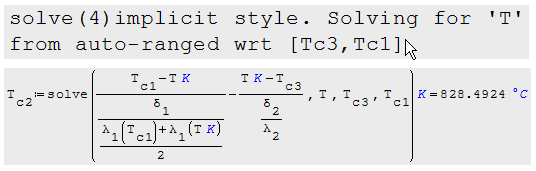

#14 Опубликовано: 23.05.2023 16:46:53
Sorry, done myself.
Here is an alternate way to solve your variables.
