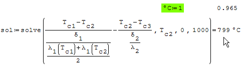

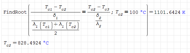

WroteWhy no solution?
Units?

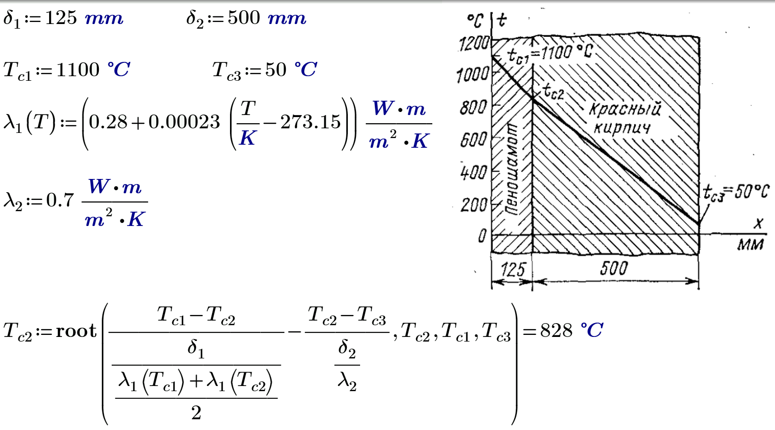

With Roots and without units - OK!
Krasnoshchekov-Sukomel-10-10.sm (209,72 КиБ) скачан 1357 раз(а).

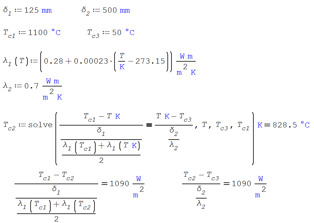

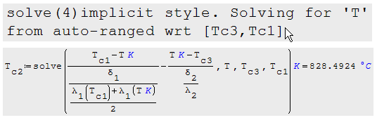

Wroteroot is undocumented in Smath. However, we have applications.
Solve Inverse [Seeded Scanner QUICK TRACK] Copy.sm (150,91 КиБ) скачан 1143 раз(а).
WroteSend please the SMath file!
Krasnoshchekov-Sukomel-10-10_findroot.sm (206,95 КиБ) скачан 1373 раз(а).

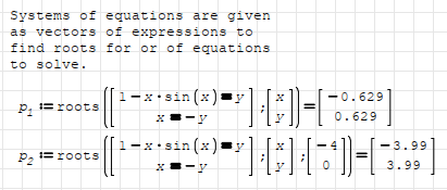

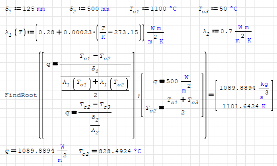

WroteCan we do it with the roots function with 2 or more equations and unknowns?
Please, attach a document to evaluate the request.

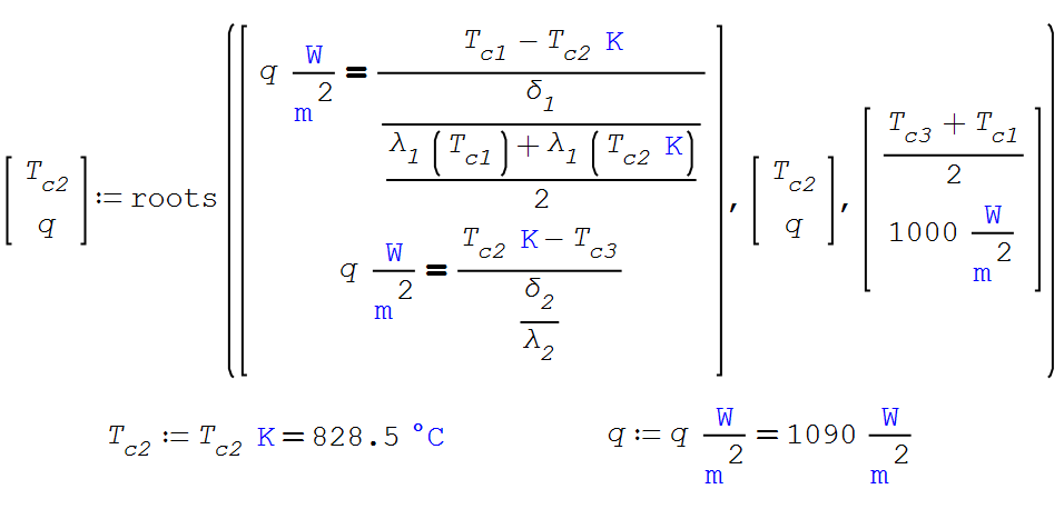

WroteWroteCan we do it with the roots function with 2 or more equations and unknowns?
Sorry, done myself.
Krasnoshchekov-Sukomel-Alan.sm (13,42 КиБ) скачан 1350 раз(а).
