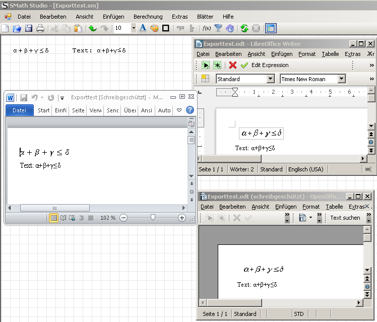

Try the attached DataExchange.dll
images now have the correct size, thank you for the bug fix. Also, direct word read in is possible (zugstab-export-1.odt). However, in this case only images and text regions are read, all math regions (formulas) are broken.
Intermediate load and save with libreoffice (zugstab-export-LO-1.odt) improves the word import, still the formatting of control structures is broken.
In general, opening both odt files with word generates error messages. If saved as docx from Libreoffice, then Word can read the file cleanly, still formatting is broken (mainly due to centering of math items)
Martin
I've found (and removed) the cause of MS word annoying message.
Any ODT Formula it's composed by two parts: the first, a MathML Markup code, and then the StarMath code (what do you see in the Formula editor as "the code" ). Both LibreOffice and OpenOffice don't require the first one, but seems that MS Word (although not explicitly) need it. Some little test that I've done to introduce the MathML code don't produce the expected result so, as for now, the MS office compatibility is limited to texts and images. [edit] The MathML code will be available ASAP.
Actually an idea could be to add an option to export ODT formulas as images; Further improvements could be added with the next OpenOffice or LibreOffice SDK.

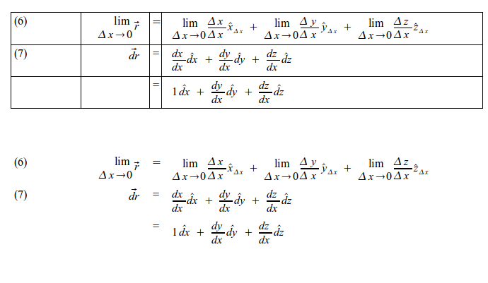

Rising Eagle
Rising Eagle
15 сообщений из 23 понравились пользователям.
P.S. the MS Word compatibility of ODT documents containing formulas was reached; with regard to the alignments of the functions I haven't found a way to force MS Word to do it.
Websurfer,
Very impressed with your projects.
Don't know if this is relevant or how sophisticated you want to be about reformatting stuff, but this thought may be of use. MS word has a facility (as does LO) called tables. When tables are created, each area in the grid is like a mini-page on its own and can be formatted independently of all the others. To align equations, make a 4 column table, put the equals sign (=) in the third column, and narrow the column width to the minimum needed to leave the equals sign visible. Then place equation numbers in the first column, and the LHS and RHS expressions in the second and far right columns. Align the LHS to the right and the RHS to the left. All equals signs and RHS expressions to follow on subsequent lines will be aligned properly.
In the LO file below, tables are used with mathml formula objects in the second and far right columns. Text is used in the first and third columns. This table formatting works in MS office as well. I adjusted the font size of the equals sign until it looked right.
Btw, how does one make math expressions (is it latex?) in these forum posts?

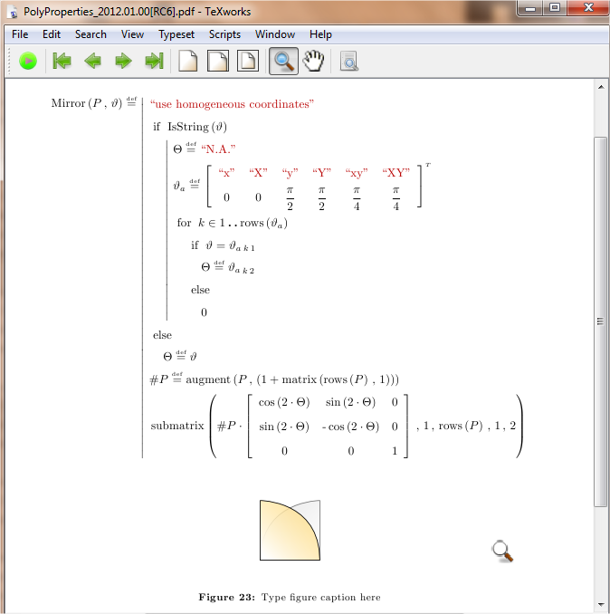

PLUGIN UPDATED
  • added "Save as... > LaTeX Text Document";
  • ODT saving:
    - ouptut ODTs now are compatible with MS word (brackets looks better than saving the file from libreoffice)
    - added options on ODT saving (Save text as images/Save formulas as images/evaluate equations)
    - "Print Area Regions" settings from "Page Setup..."
    - SMath texts on multiple lines now are shown on multiple lines even in the output file.
    - minor changes
  • ODF saving: each evaluation (input formula/symbolic/numeric) written on a different line of code;
  • Embedded languages: ENGLISH/ITALIAN/RUSSIAN
best regards,
w3b5urf3r
Mike Kaganski 25.01.2013 18:34:00, Radovan Omorjan 25.01.2013 12:39:00, sergio 25.01.2013 14:52:00, Oscar Campo 29.01.2013 15:45:00, Martin Kraska 25.01.2013 17:17:00

Hello w3bsurf3r,
thanks for updating the plugin. The Latex-export looks great (not yet tested, but your preview looks promising).
Just a small remark:
default export path is not defined by where the current sm file is but by the current directory. If you first launch SMath, then the current directory for the entire session regardless which files are opened afterwards is where the executable is.
As plugins need to be used with the msi-Installer version, the executable path is normally read only and example execution fails. Anyway you do not want to clutter the install dir by accidental export data.
When you just launch a sm file in the file manager, then current dir is equal to sm file dir.
If you have any chance to determine the sm file path name independently from the current dir, then I would recommend to use this and thereby be consistent to what your docs and examples say. This is would make the target dir more predictable and independent of how the file was opened. Otherwise the comments in the examples might need correction.
Martin

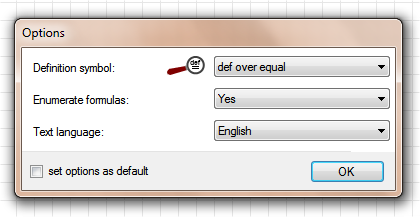

Hello W3bsurf3r,
after a closer look to the latex export I recommend the following:
- left align the equations using \usepackage[fleqn]{amsmath}
- typeset the break and continue statements in roman (mathrm)
- remove all empty lines (less space between equations)
- provide choices (if possible with adjustable default settings) for
- assignment operator (:= vs def over =)
- equation numbering (starred or unstarred equation environment)
Martin
Hi rising eagle, It's a good idea but quite complicated to generate undefined levels of nested equations/statements (but I've done something similare for LaTeX, where tables and formulas can be mixed easily).
-- assignment operator (:= vs def over =)
-- equation numbering (starred or unstarred equation environment)
- left align the equations using \usepackage[fleqn]{amsmath} -> done
- typeset the break and continue statements in roman (mathrm) -> fixed (LaTeX/StarMath/MathML) (\operatorname may be better?)
- remove all empty lines (less space between equations) -> mhhh... we don't lose tex file readability from the user?
ok... consider that actually you can easily change the define equal of the entire file by editing the header
\newcommand{\defeq}{\stackrel{\text{\tiny def}}{=}} % SMath 'define equal'
best regards,
w3b5urf3r
[DONE] (can memorize settings)
