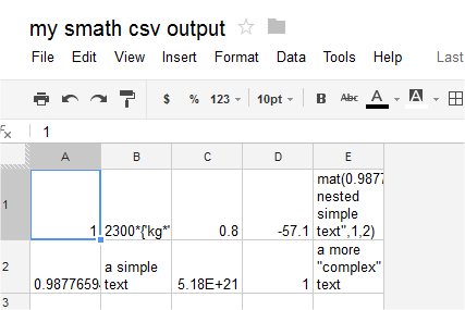

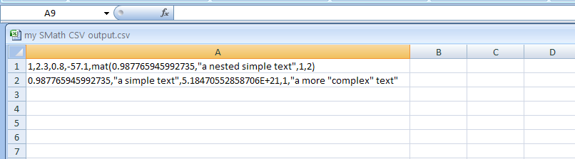

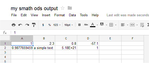

Test on xp:
-the sample does not report errors but now it outputs csv and ods at the same directory as the smath sheet.
-the ods file can't be opened with excel_2007_SP1 but it seems that is required at least 2007_SP2
-the output files does not correspond to the matrix on the sample, see screenshots.

Hi kilele, thank you for your examination
The outputDirectory value it's customizable, in the new DataExport.sm the first definition only it's enabled (output sent in the sheet folder).
I consider the 2nd issue a SP1 lack (otherwise the SP2 did not contain any changes about ODF); consider that you can open the ODS with a LibreOffice/OpenOffice for free (even with a portable app) and resave the file as a *.xls or a *.xlsx file.
Consider that a csv file works fine when you share numbers and text; the example contains also nested matrices for testing purposes but I would not recommend to share SMath symbolical data using a CSV file. Besides to load correctly a CSV in MS office you need to import it (On the Data tab, in the Get External Data group, click on "From text" > choose the file to load, set delimiters and others options...); LibreOffice start the import procedure when you open the file, so there are not issues... EDIT obviously I can extend the CSV export features to export symbolical data as a string.

since the export sample worked as in my test on xp the other day, see screenshots above.

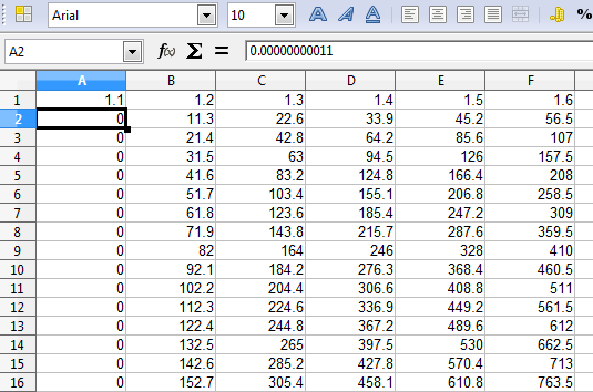

Just tried a bit to see the ODS I/O functions (LibreOffice 3.5.7). I used a bit larger numerical data table. This is one of the most desirable feature expected from the import/export data function AFAIC. Just see the picture, please. It seems quite Ok. By the way, as we all know, it is not desirable to represent the entire large matrix in SMath. It will cause troubles by occupying large amount of space.
The first picture is some data made in Calc. The second one is an import to SMath. The third one is made by exporting the matrix. I have no complaints about it. It seems it works just fine, although I was just curious why the scientific format changed while importing and exporting. Actually, I think this is not a big issue.

Hi omorr,
I did not thought to format the cells for the exponentials... it not require a great effort, I could add this feature tonight
