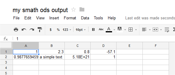

ODS fixed (I hope)
You're right, you can use any existing path where you have permissions to read and write files (BTW inserting or not a backslash at the end of the filepath doesn't cause issues).
I know, we can't paste nothing (text with/without spaces or numbers) inside a text variable (a variable enclosed by "" ); your workaround is certainly not trivial but solves me many issues
best regards,
w3b5urf3r

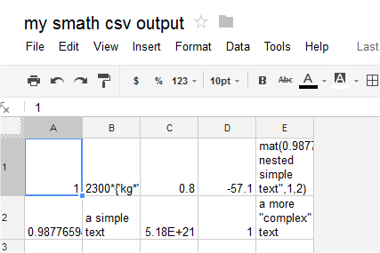

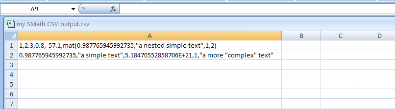

Test on xp:
-the sample does not report errors but now it outputs csv and ods at the same directory as the smath sheet.
-the ods file can't be opened with excel_2007_SP1 but it seems that is required at least 2007_SP2
-the output files does not correspond to the matrix on the sample, see screenshots.

#14 Posted: 12/17/2012 9:24:26 PM
1,443 likes in 2,935 posts.
Ah, yes...
I've forgot to fix a couple of issues in the ODS/CSV exporting with units of measurement (now processed as symbolic data) and nested quotes; the issue revealed itself by opening the exported files with google docs, now seem that work fine...
fixed & updated REMEMBER TO DELETE ANY OLD PLUGIN ('DataExport.dll' or 'CSV export.dll', if any)
As for the MS Office 2007 SP1 import of ODS files, my idea still remain to convert the file with a third party application (LibreOffice/OpenOffice/webservice); alternatively, here there is a free ODF Add-in for Microsoft Office or the official "2007 Microsoft Office Suite Service Pack 3 (SP3)" (or we can hope for a future evolution of the xls plugin...)
best regards,
w3b5urf3r

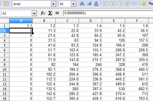

Hello w3b5urf3r,
All my respect for this plugin as well ,
Just tried a bit to see the ODS I/O functions (LibreOffice 3.5.7). I used a bit larger numerical data table. This is one of the most desirable feature expected from the import/export data function AFAIC. Just see the picture, please. It seems quite Ok. By the way, as we all know, it is not desirable to represent the entire large matrix in SMath. It will cause troubles by occupying large amount of space.
The first picture is some data made in Calc. The second one is an import to SMath. The third one is made by exporting the matrix. I have no complaints about it. It seems it works just fine, although I was just curious why the scientific format changed while importing and exporting. Actually, I think this is not a big issue.
#16 Posted: 12/18/2012 9:10:47 AM
Hello w3b5urf3r,
Hi omorr,
I did not thought to format the cells for the exponentials... it not require a great effort, I could add this feature tonight
best regards,
w3b5urf3r
