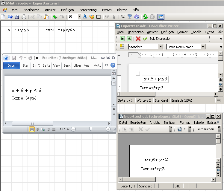

Try the attached DataExchange.dll
images now have the correct size, thank you for the bug fix. Also, direct word read in is possible (zugstab-export-1.odt). However, in this case only images and text regions are read, all math regions (formulas) are broken.
Intermediate load and save with libreoffice (zugstab-export-LO-1.odt) improves the word import, still the formatting of control structures is broken.
In general, opening both odt files with word generates error messages. If saved as docx from Libreoffice, then Word can read the file cleanly, still formatting is broken (mainly due to centering of math items)
Martin
I've found (and removed) the cause of MS word annoying message.
Any ODT Formula it's composed by two parts: the first, a MathML Markup code, and then the StarMath code (what do you see in the Formula editor as "the code" ). Both LibreOffice and OpenOffice don't require the first one, but seems that MS Word (although not explicitly) need it.
Actually an idea could be to add an option to export ODT formulas as images; Further improvements could be added with the next OpenOffice or LibreOffice SDK.

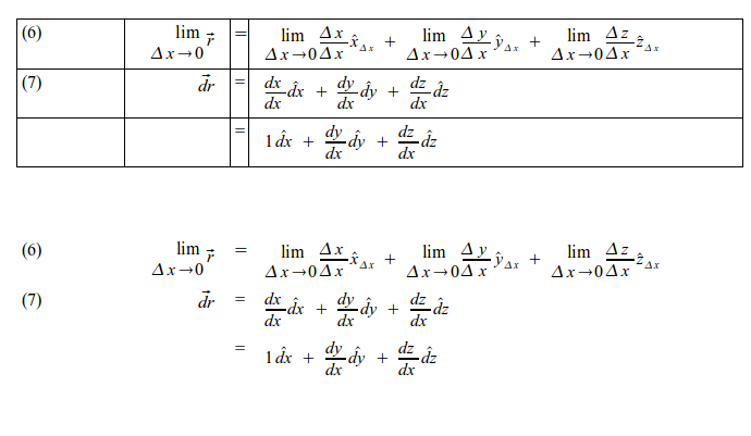

In the LO file below, tables are used with mathml formula objects in the second and far right columns. Text is used in the first and third columns. This table formatting works in MS office as well. I adjusted the font size of the equals sign until it looked right.
Btw, how does one make math expressions (is it latex?) in these forum posts?

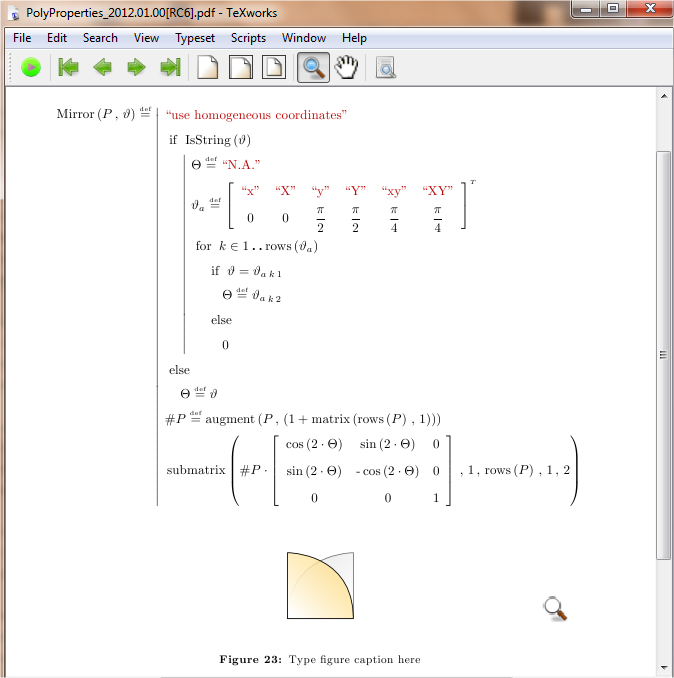

![PolyProperties_2012.01.00[RC6].pdf - TeXworks.png](/en-US/files/Download/cRGRmP/PolyProperties_2012.01.00[RC6].pdf---TeXworks.png)
thanks for updating the plugin. The Latex-export looks great (not yet tested, but your preview looks promising).

Hi rising eagle, It's a good idea but quite complicated to generate undefined levels of nested equations/statements (but I've done something similare for LaTeX, where tables and formulas can be mixed easily).
About formulas in forum posts look here

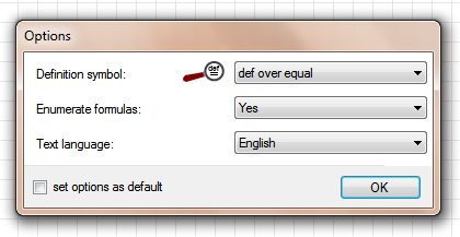

[DONE] (can memorize settings)Wrote- provide choices (if possible with adjustable default settings) for
-- assignment operator (:= vs def over =)
-- equation numbering (starred or unstarred equation environment)
