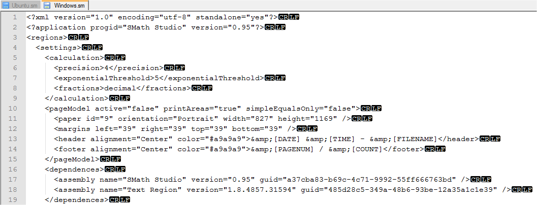

The CR/LF (carriage return/line feed) problem is one that I had to handle in my Linux days (when Win 3.1 was too unstable for real work). ASCII files (as the sm files are) have different line break encoding under Windows and Linux, see wikipedia. Programs relying on the line structure of input data must be aware of this. I had to convert ascii data files e.g. for plotting using scripts like dos2unix or unix2dos.
This may be totally irrelevant for the SMath file portability problem, it is just a blind guess. Sorry for not investigating that myself, it is a question of time budget.
Martin

The path handling it's the same in all the packages, what changes is the XLSX support. Andrey will add a new variable for plugin developers to retrieve the worksheet path; until that moment relative paths will works with the current homemade workaround... I do not deny that there will still be some differences between the different distros (I'm thinking about the default path for new files), because the environment variables are implemented differently (that's a MONO issue, I think...).
The "Full package" contains the XLSX I/O functions both for Windows and Linux, so if someone can test them on Linux I'd appreciate that (although as I previously said, I expect a SMath crash).
The CR/LF difference exist (CR+LF for Windows worksheets, LF for Linux worksheets) however I do not think that produces issues.

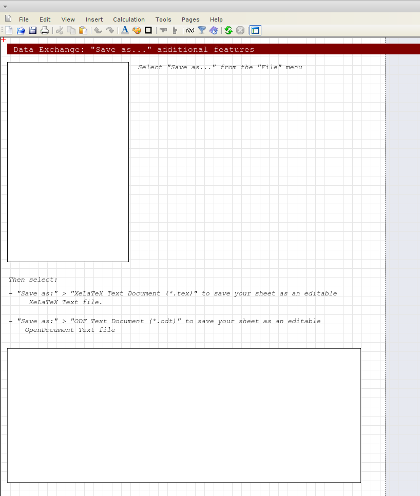

#89 Posted: 4/23/2013 9:48:28 AM
1,443 likes in 2,935 posts.
2.10.8.1 yeah... rounded to upper in my mind :-p
I can add images from the menu, but I can't load images opening the files (images appear with right size but totally white)
BTW there aren't misalignments (different OS, screen resolution and video card)
#90 Posted: 4/23/2013 10:02:50 AM
Something like this?
#91 Posted: 4/23/2013 10:05:58 AM
exactly
[EDIT] About saving, I've made in Ubuntu a worsheet with an image and works on Windows, so I think it's a loading problem.
#92 Posted: 4/23/2013 10:42:26 AM
Did you try to save the worksheet which includes some SMath plots besides the image regions? I can not do that, see please- saving in Xubuntu failed. As I could see kilele was successful with Mint- saving images works

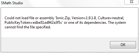

#99 Posted: 5/2/2013 4:19:52 PM
I noticed another issue involving the Data Exchange plugin and SMath Studio 0.96; trying to use the OpenDocument features SMath Studio returns something like: "unable to load the file or the assembly 'Ionic.zip, Version...' ..."
I need to know if it's a SMath issue or it's something in my Notebook.
Thank you all in advance.
w3b5urf3r

#100 Posted: 5/2/2013 5:26:47 PM
Hello Davide,
I've noticed some problems with the v0.96 and plugins as well after the updating, but ignored it for that moment because the "compact" version did not complain about them. It seems someone else had a similar experience, see here - plugin disabled? . I keep both "full" and Martin's "compact" versions. When updating from 0.95 to 0.96 from within full version, when running SMath the following error box appeared - (picture 1). I did not not know which one of the plugins were disabled and, actually, the strange thing is that it seems every plugin is there and not excluded as before. Therefore, I uninstalled and installed a "clean" v0.96. full version without plugins, keeping and using the compact version or the "clean" full version for recent testing.
Now, I tried to put only DataExchange plugin in the full version and the error reappeard (picture 1). The DataExchange was not disabled and I could use it. However, the same error you mentioned issued when trying to save as ODT in both "full" and compact version (picture 2). The question is: why the compact version does not complain about plugins . It seems that Martin did not have this problem o_o
I hope I did not make some mess here in mixing all the things together.
EDIT: Just tried to insert other plugins made by you and uni. The error did not appear in the full version. It seems something is about DataExchange and 0.96
