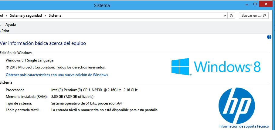

Since Smath Studio 0.98.5908 I can't install on my computer.
The instalation stops and warn me:
