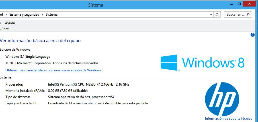

Since Smath Studio 0.98.5908 I can't install on my computer.

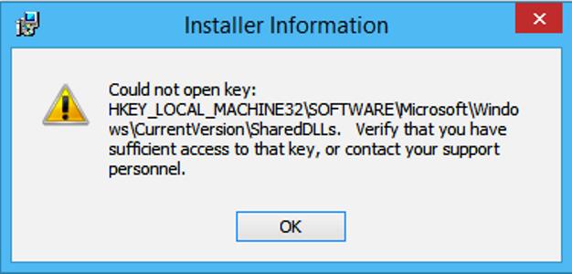

The instalation stops and warn me:

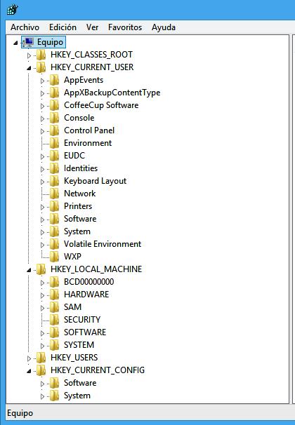

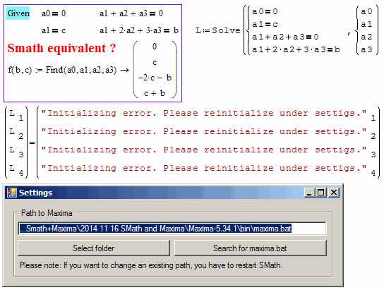

I can see that it has to be with my system, not with Smat Studio , because my system don't have the referred KEY.

#7 Опубликовано: 16.03.2016 21:04:53
Mike Kaganski
Mike Kaganski
Can you check the permissions of HKEY_LOCAL_MACHINE\Software\Wow6432Node\Microsoft\Windows\CurrentVersion\SharedDLLs?
This is the place where your HKEY_LOCAL_MACHINE32 path should redirect to.
