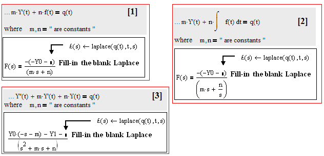

Number of ODE's have symbolic solution.
If your DE has either of these tree forms,
Smath will spits scalar solutions wrt parameters/IC ...
One of my old baby in Mathsoft Collaboratory.
Cheers ... Jean.

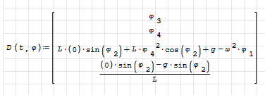

Finally, I did some animations, But I find some problems with the exported gifs. It acts like there are some missing frames while it's totally smooth inside the sheet.
Vibrating Pendulum.sm (15,9 КиБ) скачан 1302 раз(а).
Wrote...
Hi. This is a workaround for that bug: https://en.smath.com/forum/yaf_postsm75052_Problem-with-animated-gif-from-plot-region.aspx#post75052

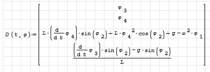

However, notice that since the values of phi are numbers and not expressions, you cannot compute the derivatives of its components the way you do in D. You can check this by substituting zero for its values, and you get the same numerical solutions.
For diff(el(φ,3),t) you can use el(φ,4), and for diff(el(φ,4),t) you should use some kind of numerical estimate.

I tried it, but still same bug exist maybe it got lowered but its still there and thanks for making me notice that mistake, does that mean we cannot solve numerically such type of DEs without assumptions?
Wrote... does that mean we cannot solve numerically such type of DEs without assumptions?
Hi Oichi. Not. Remember that given F(x,x',x'',...,t) = 0 then for using numerical DEs solvers you must to find the system D(t,x) = [x', x'', ... ] with an appropriate change of variables. Which is your original analytic expression of your differential equation to be solved? This is, the one or two equations involving both all derivatives of all "x" variables, F(x,x',x'',...,t) = 0.

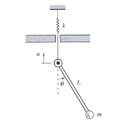

This example is for a pendulum that it's upper end is attached to a spring, The displacement of this upper end is Phi(1) "u" and the angular displacement of the pendulum is Phi(2) "theta". Phi(3) "u_dot" and Phi(4) "theta_dot" are the first derivatives of the upper end vertical motion and the angular displacement of the pendulum respectively.

WroteThis example is for a pendulum that it's upper end is attached to a spring, The displacement of this upper end is Phi(1) "u" and the angular displacement of the pendulum is Phi(2) "theta". Phi(3) "u_dot" and Phi(4) "theta_dot" are the first derivatives of the upper end vertical motion and the angular displacement of the pendulum respectively.
Thanks for explaining your advanced project.

WroteHi. The attached file uses the techniques shown here and here. You can also obtain the equations of motion using the lagrangian with what is shown here.
Vibrating Pendulum.sm (116,24 КиБ) скачан 1321 раз(а).
Vibrating Pendulum.pdf (183,21 КиБ) скачан 760 раз(а).
Thank you so much ^^, ODEs were already obtained using Lagrangians and Hamiltonians but I did them on a paper
