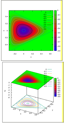

#14 Опубликовано: 03.01.2021 11:28:34
Thanks, works fine after doctoring CreateMesh.

Vibrations of a triangular membrane(Maxima)
TriangularMembrane Maxima.sm (279,28 КиБ) скачан 1455 раз(а).
