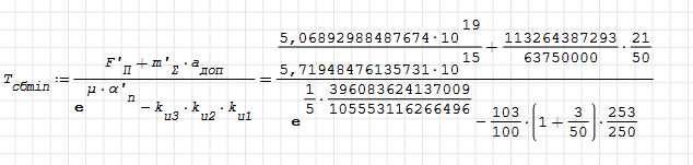

#8 Опубликовано: 30.03.2024 01:40:58
TopUser2000
TopUser2000
0 сообщений из 28 понравились пользователям.
Note: it has a little bit of a learning curve, but is worth considering never-the-less.
I don't see the result in the attached screenshots of how it works. A jumble of formulas where there is no clear answer.
