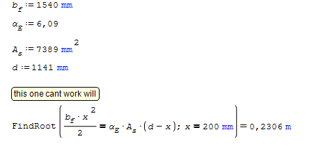

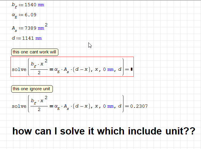

I think solve function cant solve with unit,who can help me?
Test about solve.sm (5,89 КиБ) скачан 1572 раз(а).

Try this:

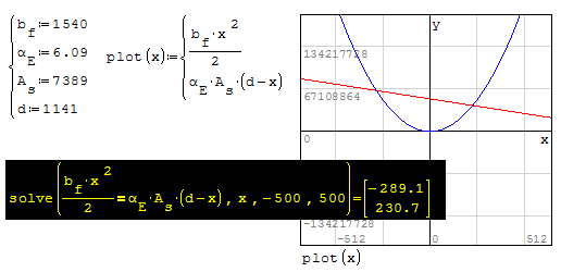

Why not work maths as they exist from the cave man, i.e: unitless ?

You can also use FindRoot from the NonLinearSolvers plugin, well documented, for details, in Martin Kraska guide

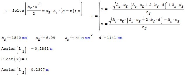

This is the version with the Maxima plugin:
solveunits.sm (7,86 КиБ) скачан 1565 раз(а).

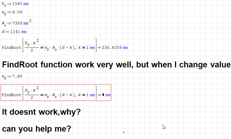

Jacques CHEN
Jacques CHEN
0 сообщений из 11 понравились пользователям.
Try this:
in this way, I need install maple?
I am try to solve EQ with unit. Thank you too!
#12 Опубликовано: 23.10.2019 16:39:40
Jacques CHEN
Jacques CHEN
Thank you! this way is very good. But I find another problem.
Test about solve.sm (6,49 КиБ) скачан 1604 раз(а).
#13 Опубликовано: 23.10.2019 17:10:47
FindRoot performs implicit assignment to x.
Therefore, you have to Clear(x) before you can solve for x again. Just as demonstrated in the Maxima example above. There, the solution is assigned explicitly using Assign() from the Maxima-Plugin
See Interactive Handbook> Function Index> Assign or Solve
#14 Опубликовано: 23.10.2019 18:05:54
Jacques CHEN
Jacques CHEN
thank you sir. I solve my problem!

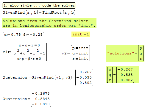

I solved my problem !
Read carefully the attached.
Solve Given_Find [System Demo epsilon].sm (25,89 КиБ) скачан 1384 раз(а).

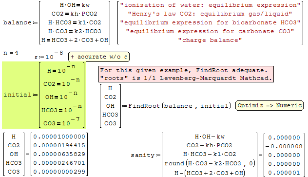

#16 Опубликовано: 24.10.2019 11:09:03
Read even more carefully the attached.
All in all: Smath solvers has solved all Mathcad 11 great projects.
The bugger in Smath FindRoot is 'ε'
i.e: needed or detrimental [detrimental in attached Butler].
To make it clear, Mathcad Given Find is Mathsoft proprietary.
It has no competition in difficult applications.
Some projects toke weeks, from brain storm collaboration.
Cheers ... Enjoy Butler.
Solve Given_Find [CO2_6179].sm (34,34 КиБ) скачан 1437 раз(а).

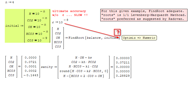

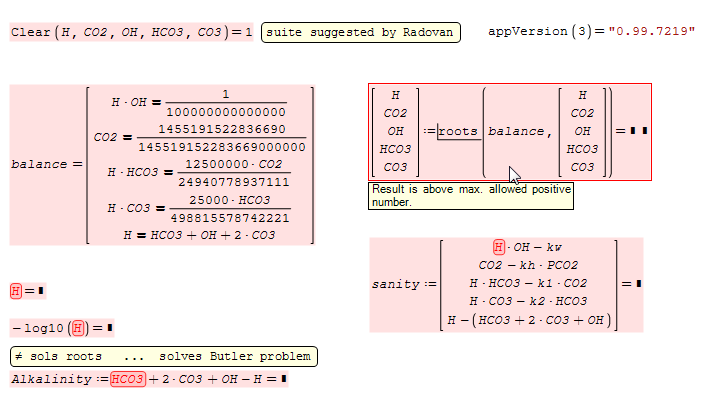

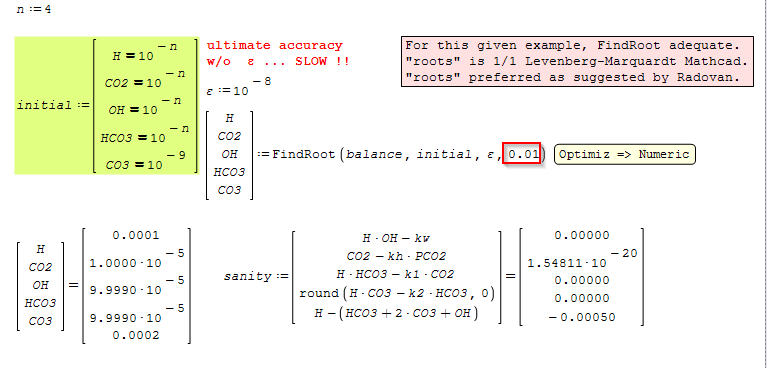

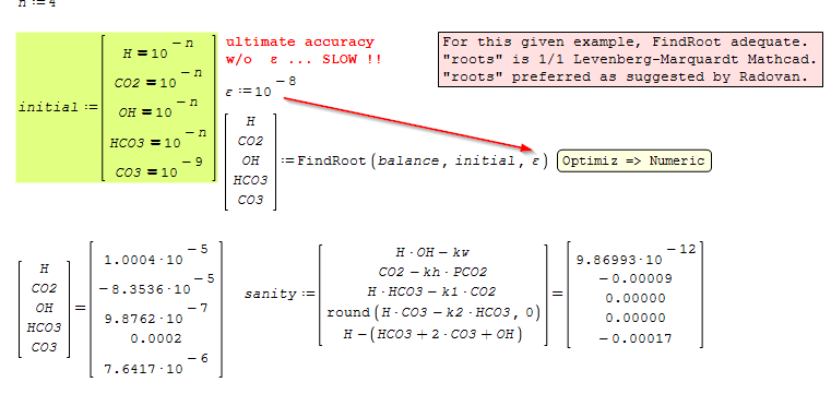

Hello Jean,
It seems something is wrong here. Results seems to be doubtful and I think epsilon is missing as a third argument in FindRoot()
If I add it
Playing with the fourth argument will give
Moreover, roots() will fail

Quite right Radovan, many things don't cut the mustard !
1. "roots" fails in your version, but superb in my native SS 6179.
2. "epsilon" deteriorates the solver in this FindRoot application.
3. The system reacts like proportional/commutative wrt reactants.
What matters is the balance [Alkalinity] 0.0000012
sounds pretty good to me ? Should revisit the paper problem,
Reference: Butler, Carbon Dioxide Equilibria, Prob. 2-11, pg 41
