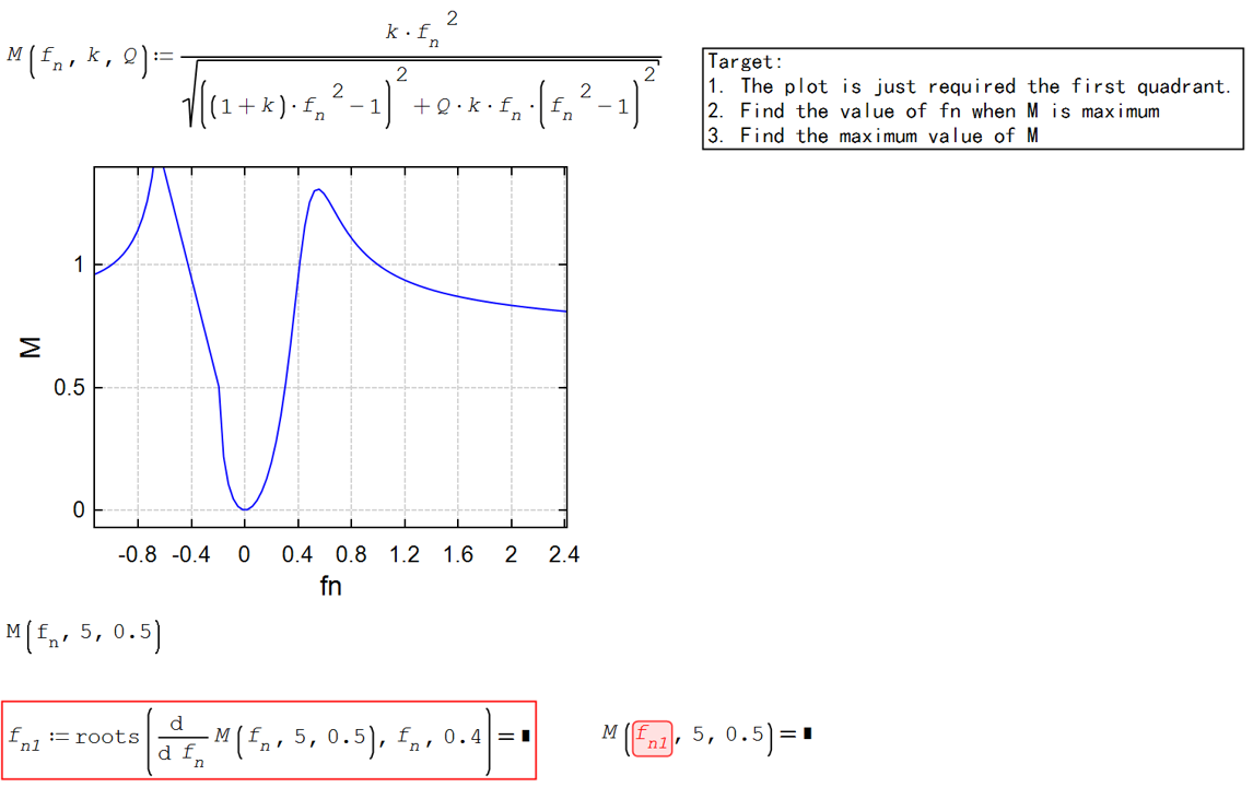

Hi, guys:

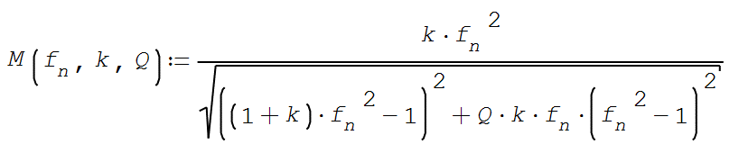

Here is a formula
And the Targets are:
1. Draw the plot, but only the first quadrant is required.
2. Find the value of fn when M is maximum.
3. Find the maximum value of M.
I did the 1st target successfully, but can not find the values of fn and M. I have tried my best and search the forum but could not find any way to fix it. Please help to fix it, Thank you very much!
LLC.sm (12,37 КиБ) скачан 1240 раз(а).

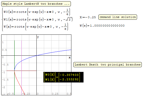

You need the Golden ratio ... doctored version.
If the function is a data set, spline/smooth the region
... as well the FindIndex is a good utility.
LLC Doctored for MAX.sm (27,88 КиБ) скачан 1196 раз(а).
Golden ratio QUICK Copy.sm (123,8 КиБ) скачан 1238 раз(а).

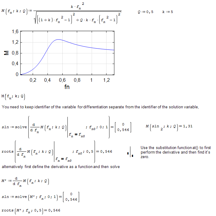

The built-in functions are perfectly well suited for the purpose. You just need to separate differentiation from root finding.
LLC.sm (11,01 КиБ) скачан 1217 раз(а).
