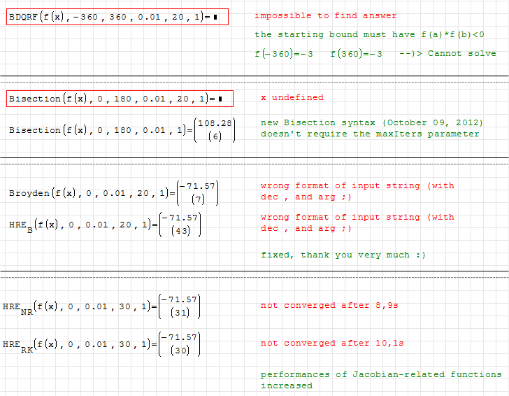

I did some simple testing, here are the results.
The screenshot is generated with standard settings for dec and arg delims.
Broyden and HRE.B generate errors with non-standard settings (dec , and arg . All other errors seem not to be custom settings related.
Quite interesting that solve(4) outperforms them all in the given example.
Most solvers that take intervals as arguments just allow one root in that interval.
Best regards, Martin
Thank you again Martin
see the attachment, the issues are fixed with the plugin in the following post.
regards,
w3b5urf3r

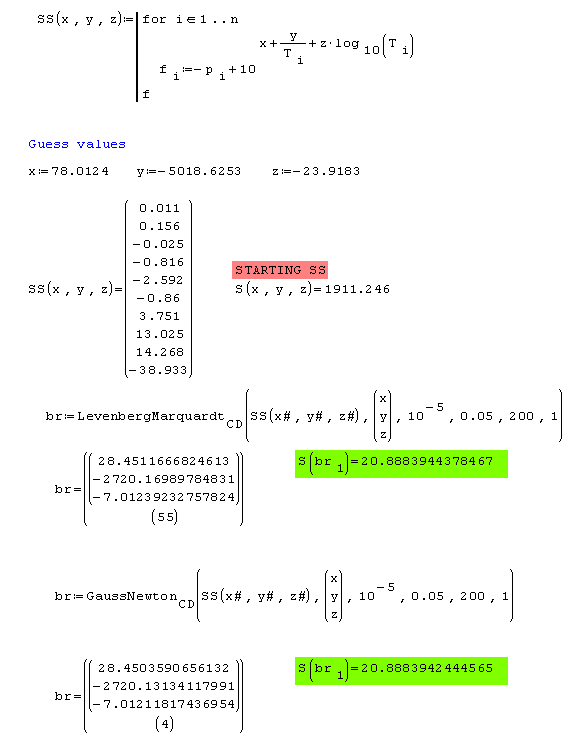

I was playing a bit with optimization .CD functions - of course with my "famous" NLS example. The calculation time decreases on some more acceptable level (order of magnitude - few minutes each) and I could afford more runs for this testing. It seems that for this example the best performance had GausNewton.CD, NewtonMethod.CD and NewtonMethod.CDGSS. Morover, NewtonMethod.CDGSS performed the best (with a bit longer calculation time) - just compare with the result obtained by my LMA() function in the same file. I was expecting much more from LevenbergMarquardt() - to be quite good at this example, but it seems I was wrong. It was quite slow and rather inefficient. Actually, CD functions did some quite good job compared to the original ones. Hope that some more improvements could be done here
The attached are two files (worse and better initial conditions).
The picture is for the worse ones.

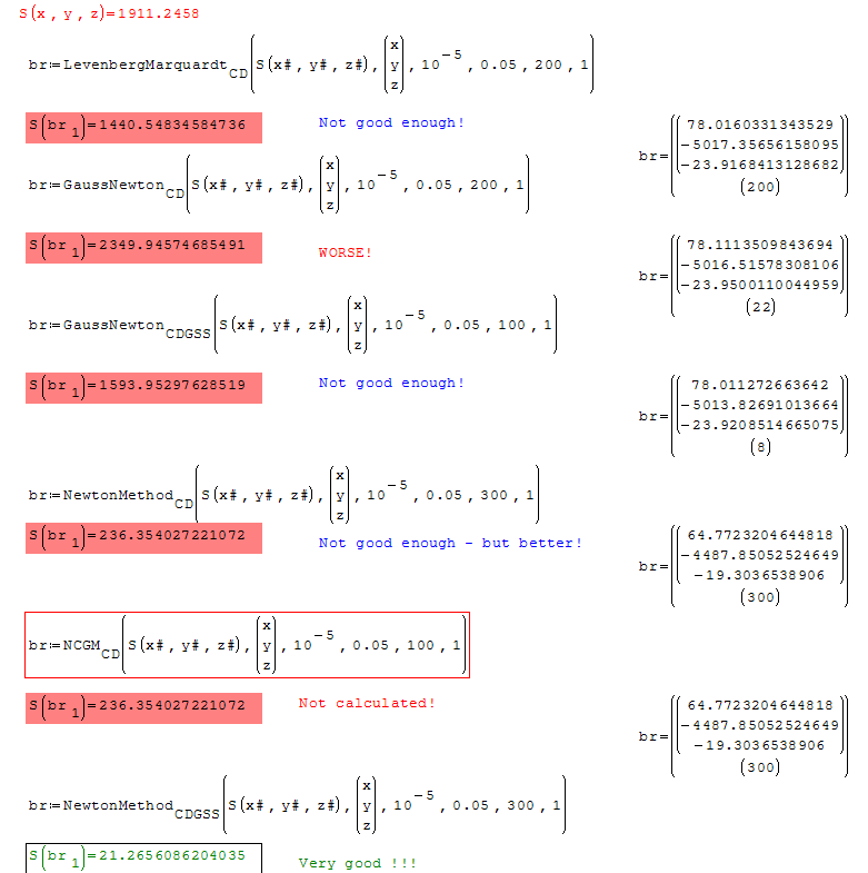

Here is another attempt, with the same problem but now directly minimizing the following standard sum of squared residuals - function S(x,y,z):
[MATH=eng]S(x,y,z):sum(((el(p,i)-10^{x+y/el(T,i)+z*log(el(T,i),10)})^2),i,1,n)[/MATH]
Again, it seems that NewtonMethod.CDGSS() performed the best for this example. Here are two files with better and worse initial conditions. The picture represented solutions with better initial conditions. I tried with different number of points (reduced the variable n in front of the function S(x,y,z) and the situation seems to be similar. NewtonMethod.CDGSS() was the best.
Those functions are promising requiring less computational time and hope that this testing and examples could give you some ideas how to increase the performance of those functions

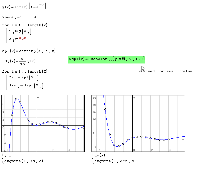

It seems you've done something with the numerical derivatives - it seems quite accurate
Just for comparison see the post and the picture above regarding spline and spline derivatives . Jacobian.CD() - Gradient.CD() did the job quite well
Thank you very much

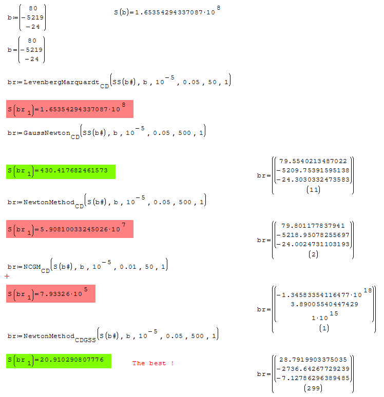

Instead of minimizing sum of squared residuals, I've tried now to use individual residuals in order to minimize them, that will sometimes work (Levenberg Marquard should do the job here). It appeared that it worked well and quite fast for most of the methods . See the attached files *7.sm and *7a.sm (better and worse guess values)
On the other hand, the squared residuals minimization is represented in files *8.sm and *8a.sm. It also worked quite well . Therefore, I am quite satisfied with these CD functions and this example solved in this way. Will see some other example next time.
P.S. It seems that NewtonRaphson.CD() is something wrong. I could not solve my test problem properly, as I was expected based on the previous post regarding numerical Jacobian. On the other hand, in your test file, NewtonRaphson() solved the problem in 7 iteration but NewtonRaphson.CD() solved the same problem in 344 iteration ?

Hello w3b5urf3r

Hello w3b5urf3r,
Thank you very much
I'm surprised o_o ; I've done nothing strange, just a "generalization" of Finite difference in several variables... maybe have you changed some parameter in your test (f.e. the perturbation value)?

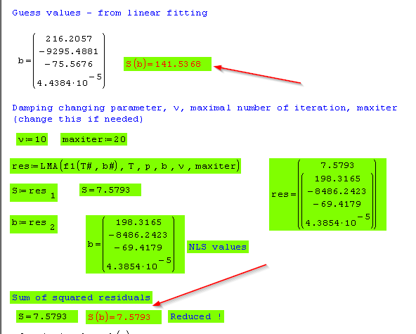

this is a LM coded in Matlab with three numerical examples to test its numerical robustness.
see "Levenberg-Marquardt method: introduction and examples" and "Levenberg-Marquardt method: m-files"
at http://www.duke.edu/~hpgavin/ce281/
And "Iterative Methods for Optimization" by C.T. Kelley has matlab codes for LM and code for numerical derivatives.
