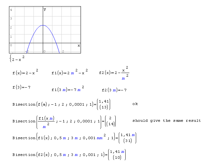

#121 Опубликовано: 31.01.2013 22:15:37
Hello w3bsurf3r,
I played around with nonlinear solvers, unfortunately without any success. At least not if units are involved.
Are the solvers supposed to work with units?
- can the unknown variables have units (given via units of limits or start point)?
- need the epsilons have units as well?
do I need to define functions or can I just give expressions as first argument?
Are the solvers supposed to work with units? -> yes...
- can the unknown variables have units (given via units of limits or start point) -> yes...
- need the epsilons have units as well? -> yes, of course...
...but something is clearly broken, somewhere (here there is an example of applications with units)

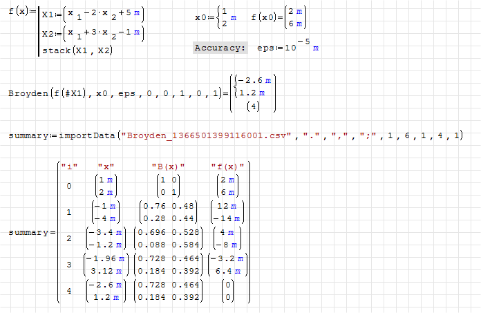

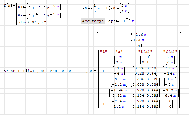

#122 Опубликовано: 01.02.2013 05:32:14
kilele
kilele
Davide Carpi 01.02.2013 07:00:00, Martin Kraska 01.02.2013 06:13:00

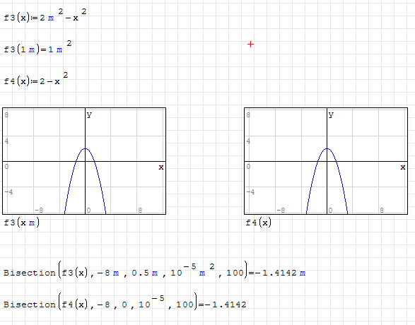

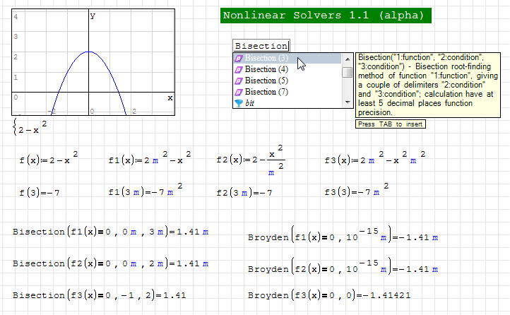

#123 Опубликовано: 01.02.2013 06:34:41
Thanks, kilele, for the examples.
Indeed most of my problems were caused by my wrong assumption of epsilon being a tolerance to the unknown variable to be solved for. Obviously it is a tolerance to the function. I remember that we had a discussion on the subject if we should have tolerances to variables and function values and how to specify them. For now I shall assume that all implemented Solvers assume function tolerances.
The question of function vs. expression remains open.
Martin

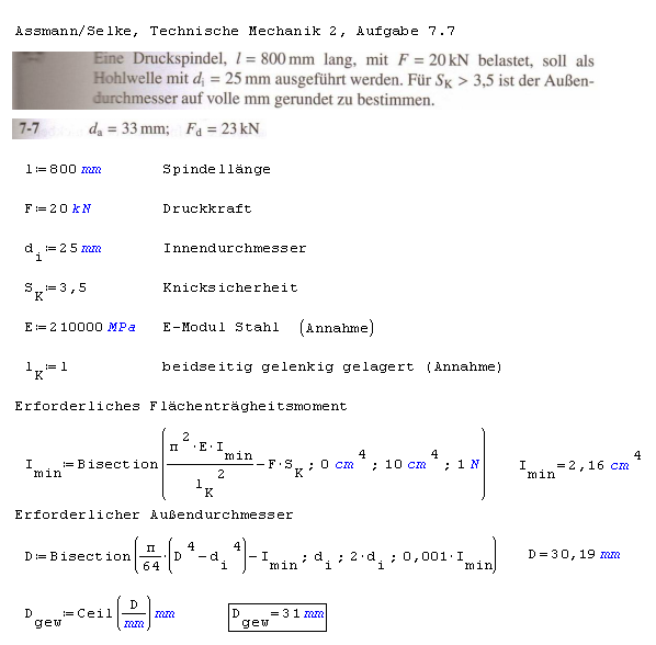

#125 Опубликовано: 01.02.2013 08:06:43
The Bisection test file in the plugin docs is outdated (examples have the now removed iterations argument). I attached a corrected version.
Martin
Bisections_testing.sm (29,1 КиБ) скачан 1622 раз(а).

#127 Опубликовано: 01.02.2013 16:07:48
Hello w3bsurf3r,
thanks again for the help. Now I can take advantage of the unit capabilities of your plugin at least for scalar equations. That already renders the solution of my example quite lean. No need for dimensionless variables any more.
Martin

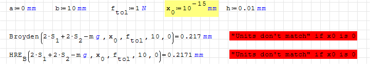

#128 Опубликовано: 07.02.2013 12:53:10
Hello w3bsurf3r,
I am again running into problems with equation solving. I never can exclude wrong operation but these seem like bugs.
Broyden and HRE.B do not handle zero starting values
Brent fails to solve a linear equation.
Martin
AS 3-26 solvers.sm (200,49 КиБ) скачан 1536 раз(а).
#129 Опубликовано: 07.02.2013 13:22:45
Hello w3bsurf3r,
Martin
Hi Martin,
Yes, Broyden can't be solved with units if you use a null initial guess... In SMath Studio the 0 value have no units by default, I've already mentioned this behavior writing the first UoM() snippet function (I'm not sure if this is related to some SMath feature or it's a simple lack).
I can improve the function looking for units inside the 2nd error parameter (if any), but nothing more... As for now you can use a small number (f.e. 10^{-15}*'mm)
About Brent I see an "Units don't match" error, I need to investigate...
Thanks again for your testings
w3b5urf3r

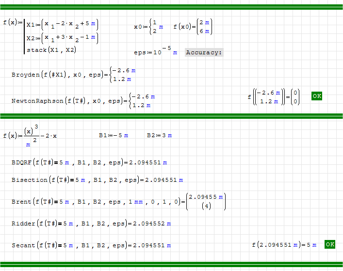

#130 Опубликовано: 07.02.2013 18:40:19
Hi w3bsurf3r
wondering why this problem obviously does not affect Newton Raphson, I came to the conclusion
The unit of measurement of the unknown can be obtained by dividing the unit of measurement of the function at x=0 by the gradient at that point. This works as long as
  • the gradient wrt the unknowns can be generated symbolically
  • the gradient is defined and nonzero at x=0
In fact, nothing else than dividing f by it's gradient is done by NR, such that the mentioned conditions should be more or less also the conditions for applicability of NR.
Martin

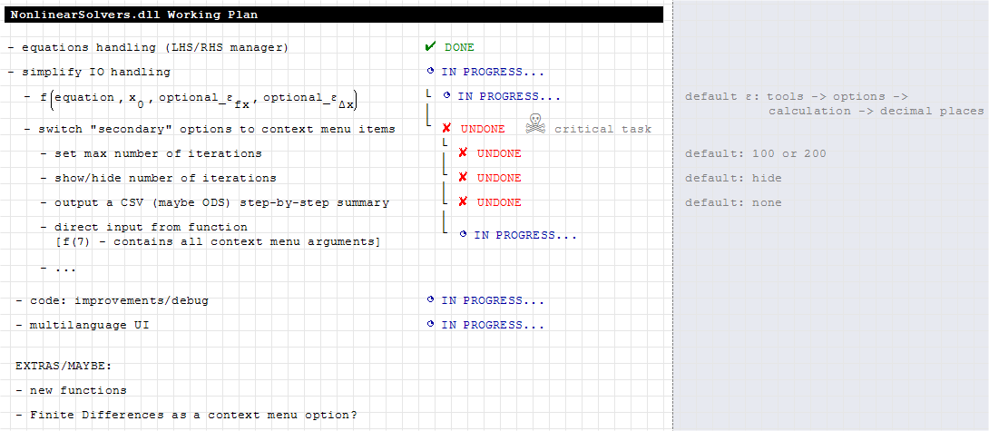

#132 Опубликовано: 26.02.2013 10:27:53

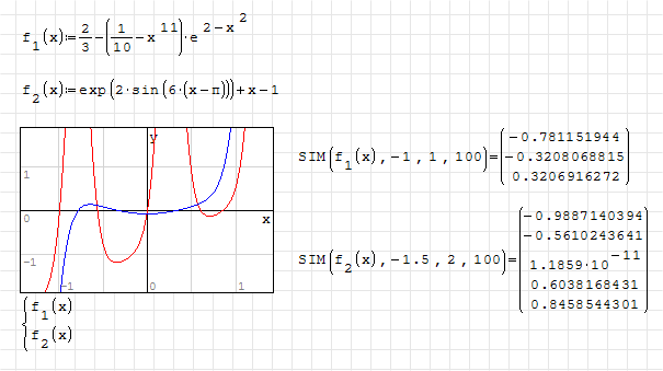

"The plotted course"
EDIT: previews
SMath Studio - [Units Testings.sm]_1.pngSMath Studio - [Units Testings.sm]_2.pngSMath Studio - [Units Testings.sm]_3.png
Radovan Omorjan 26.02.2013 17:13:00

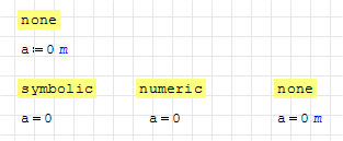

In general, 0 is more than just a real number or place holder representing, in this case, an empty set. When it comes to systems with units, 0 is actually a chameleon with universal units (in the same way that type O blood is for universal donor). It can be handled by either treating each 0 as a function that transforms the number unitless 0 into a 0 with units of its surrounding factors as appropriate for the calculation, or by changing the rules of the uses of units as programmed into smath so that units associated with 0 (whether present or not) are completely ignored and all unit determinations are made by use of units provided by all non-0 factors.
#134 Опубликовано: 04.03.2013 19:25:31
I agree with your logic
However I hope that in future the numeric optimization can preserve the units for zero values

However (IMHO) the native units support for zero values in SMath would be very appreciable
I'm agree. Do you have an exact example (which requires no additional plug-ins) where I can see an issue?
