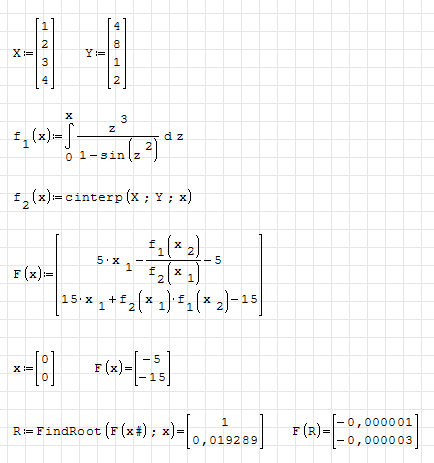

#224 Опубликовано: 16.05.2017 23:32:46
Maybe, I don't understand much in there ?
Page1 Unknown Solve.sm (30,3 КиБ) скачан 1697 раз(а).
#225 Опубликовано: 17.05.2017 10:11:59
Helo Jean,
You should define f(x) not f(u). See the file, please. Was that your question?
Page1%20Unknown%20Solve-2-corr.sm (34,64 КиБ) скачан 1987 раз(а).

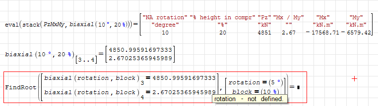

Hello SMath Community, need some help with findroot() function.
I wrote a formula (biaxial bending in a column) to calculate unknown input loads based on known response. A key to practical use of the formula is to solve for unknown response based on known input loads (backwards of what formula does). When using findroot() for this purpose i run into error:
FidRoot-CustomFormulaSolution.sm (537,63 КиБ) скачан 1645 раз(а).
What am i doing wrong?
Thanks!
#228 Опубликовано: 13.04.2018 13:36:36
FindRoot, as well as other solvers of NS plugin, is not friend of eval, if/else or in general anything that requires a strict numerical evalution to be performed... that's a thing I'm working on (long overdue, I know...)
sergio 13.04.2018 16:14:00, Alexander O. Melnik 15.04.2018 12:39:00

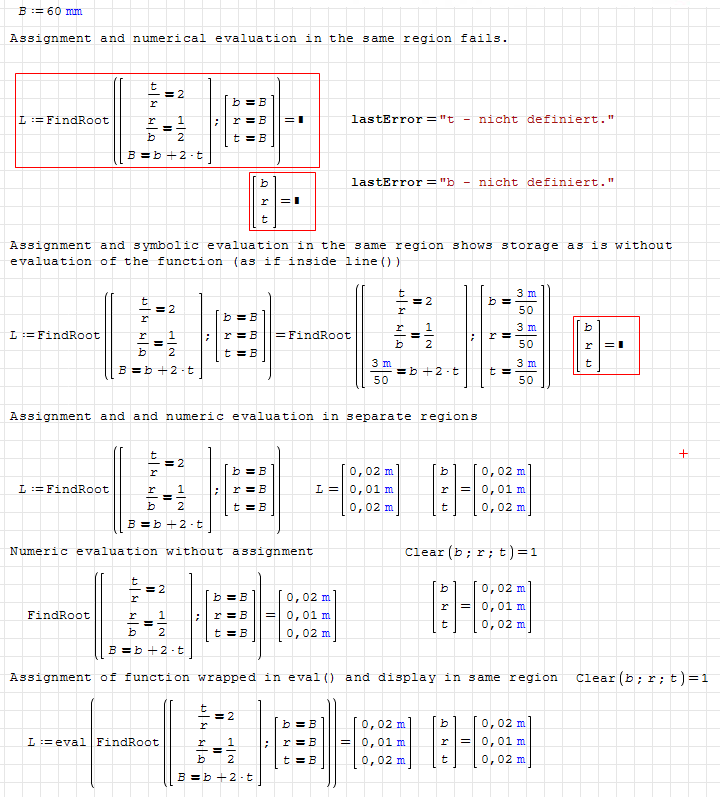

#229 Опубликовано: 11.12.2018 20:14:58
I don't know when these changes happened but my current observation of Findroot's behaviour seems to be different from earlier versions:
  • Just evaluate: displays result vector and executes embedded assignment
  • Assign and evaluate in the same region: Error (symbolic evaluation reveals that the expression isn't executed but just stored as if it was inside line())
  • Assign and evaluate in separate regions: displays result vector and executes embedded assignment upon display.
  • Assign wrapped in eval() and evaluate in the same region: displays result vector and executes embedded assignment (here, eval() seems to be a friend of FindRoot())
In the sheet below I tried to demonstrate how to solve a system of equations using FindRoot() as alternative to Solve(). However, I am not sure how to explain the behaviour to the students. Should we generally avoid assignment with integrated evaluation for the time being?
2018-12-12 00_06_28-SMath Studio - [Kerbformzahl Lochstab Biegung FKM.sm_].png
Kerbformzahl Lochstab Biegung FKM.sm (700,43 КиБ) скачан 1608 раз(а).
sergio 12.12.2018 06:13:00, Radovan Omorjan 12.12.2018 09:02:00
#230 Опубликовано: 11.12.2018 21:27:22
Yes, they should be avoided. There are several known issues while using implicit assignments, I plan to remove them when I'll have the possibility to commit a major update to this plugin.
Moreover now SMath Studio supports multiple assignments by matrices on LHS, therefore it shouldn't be a big loss.
#231 Опубликовано: 11.12.2018 21:41:25
Perhaps I wasn't clear enough. My example doesn't show any problem with embedded/implicit assignment (at least nothing obvious). What I mean is if you write an assignment with := and in the same region ask for display by = . This one seems to be a problem. Maybe, the two features are related, I don't know.
If you drop integrated/implicit assignment, perhaps would be a good idea to return a set of boolean equations which can be used with at(), just like with Solve(). Then you can easily operate with multiple solutions without having to clear inbetween.

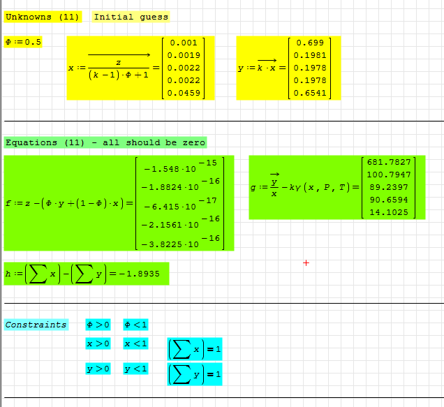

#233 Опубликовано: 10.02.2019 13:29:08
Be my guest if you want to solve it
Assuredly not a profitable guest !
I don't understand much in there.
Primer38-doomed.sm (39,31 КиБ) скачан 1523 раз(а).
Primer38-doomed_1.sm (44,63 КиБ) скачан 1465 раз(а).
Radovan Omorjan 12.02.2019 12:22:00
#234 Опубликовано: 10.02.2019 13:45:22
Thank you Jeaan for your efforts, but I think we do not understand each other. This is not a fitting problem but finding roots of nonlinear system of equations
The solution was found in Mathcad - this post - and some other software but never in SMath
#235 Опубликовано: 10.02.2019 17:59:18
Here is the same problem solved in Mathcad
Hi. Can you show the guess values for x and y? And k before Find too. I get a very different k value. Remember that for numerical procedures, guess values are part of the solution, not of the problem.
Thanks in advance.

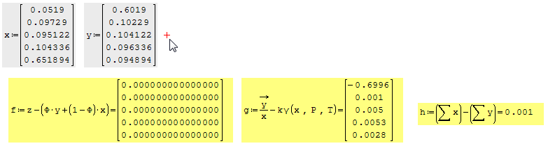

#236 Опубликовано: 11.02.2019 05:43:53
Thanks in advance.
Thank you Alvaro for your interest in these problems. Here is the file once more.
Primer38-doomed1.sm (31,96 КиБ) скачан 1552 раз(а).
This is a system of nonlinear algebraic equations. If one takes a look at the calculation here it is obvious that any gradient algorithm for solving this system will fail. Therefore, some non-gradient method might solve this (direct solving or some minimization procedure). There are some functions in the NonlinearSolvers plugin, but unfortunately, there is no update of them for a long time and many of them do not work anymore. All of these years I mentioned that we need here some well tested and robust library incorporated in SMath regarding these problems. There are no other plugins which will address these problems (AFAIK) and I am not sure that will ever be any.
Alvaro 11.02.2019 07:32:00
#237 Опубликовано: 11.02.2019 16:16:54
1. You seem not happy of the result by plugging [x, y] from the other software.
Did you enter enough decimals ? or that software is short of more ?
2. The Smath FindRoots is not robust in there but it can reproduce results
from your source software with more decimals that you collected.
3. Presumably the software is Matlab ?
4. In short: for a fixed Phi, you are attempting to solve pairwise [x,y]
as you scan over 'z'. Isn't true that any pairwise [x,y] will find a valid
solution or closely ? Stated otherwise: the unique non trivial pair [x,y]
is extremely sensitive to initials. That reminds me the Mathcad rootScanner
that I designed for some extremely sensitive initials. But that one tool
is only for one variable.
Cheers Radovan ... Jean
Primer38-doomed1[Solve paiWise].sm (10,31 КиБ) скачан 1373 раз(а).

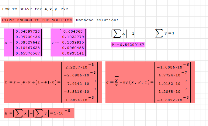

#238 Опубликовано: 11.02.2019 16:54:05
Did you enterenough decimals ?
#239 Опубликовано: 11.02.2019 17:53:56
Hello Jean,
The solution is from Mathcad (Given/Find)
With an increased number of decimals.
#240 Опубликовано: 11.02.2019 22:45:36
Hello Jean,
That was my guess, no shame borrowing the hammer as needed.
γRK(T,x):=eval(program) ... > 4 times faster.
