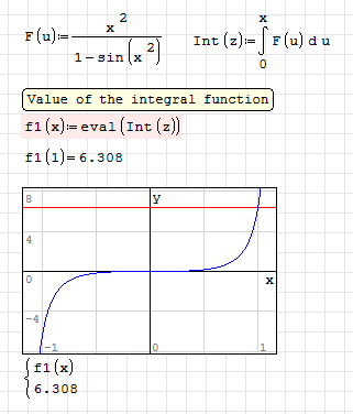

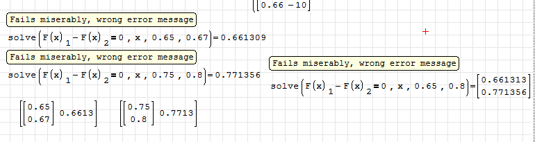

#204 Опубликовано: 25.10.2016 00:49:16
You are right Radovan,
Smath splines [ainterp, cinterp, linterp] are "canvas" plotting
and on-line evaluation. They don't create a function thus can't be
use to integrate directly. You have two alternatives:
1. Dicretise/integrate finites differences
2. Transit via Infinitesimal modules
I went as far as I could in the attached. Plotting the components.
The "solve" block fails miserably, why?
It attempts to retrieve back to the integral that Smath does not
produce. The "solve" does not interpret the integral transit because
the solve block is a foreign entity. The Mathcad find(x) looks incorrect.
It depends upon initialisation. In this case the worng checks right.
Though the Mathcad Given/Find is often robust, it failed 1000's times
in my 15 years Mathacd collab.
Mathcad plots your integral, smath does not, thus it reflects in the "solve".
Please don't hesitate to correct me if I can help more.
Cheers, Jean

#205 Опубликовано: 25.10.2016 02:43:38
Hello Jean,
The integral works form me (the recent SMath version)
solve() works for me as well
Why is this working for me and not for you - I do not know.
#206 Опубликовано: 25.10.2016 10:07:02
Simple: the solve block of your version is more robust
or the chained code less reactive ? The other curiosity

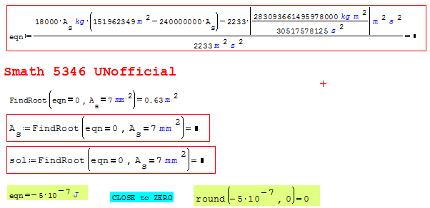

5346 official release ..... 120 sec
5346 UNofficial release.... 14 sec
I got used to solve failure, rescue dichotomy.
BTW: eval(,) is not needed for f1(x)[faster].
Thanks Radovan, your collaboration is most appreciated.

Chain code error confirmed.

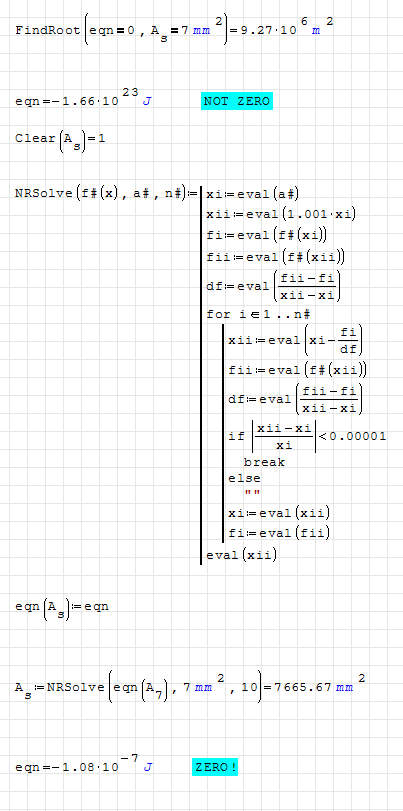

Here is an unforunate example of FindRoot() being unable to solve a problems with units... While my very quick NR Line() solver works just fine.
I wonder if we run into max + number problem or devision by zero.
Hoping for a fix!
FindRootBug.sm (11,93 КиБ) скачан 1539 раз(а).

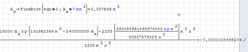

#209 Опубликовано: 27.10.2016 04:26:45
Not sure why it fails in 1.0/1.1, but will works in next version

#210 Опубликовано: 27.10.2016 09:16:03

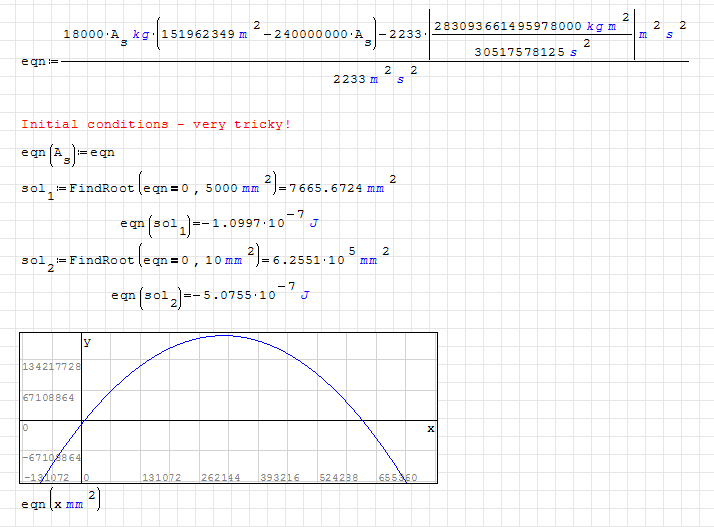

Actually, it could be done - but setting the initial conditions for FindRoot() could be very troublesome for this example.
Initial conditions are chosen just on trial and error, and the calculation can diverge easily by slight changing of IC.
This is basically a second order polynomial having two solutions.
FindRootBug-corr.sm (16,62 КиБ) скачан 1524 раз(а).

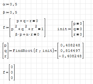

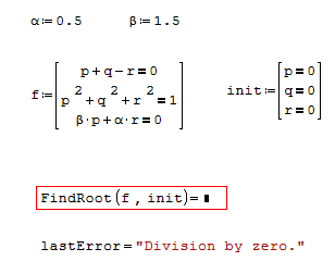

#218 Опубликовано: 29.10.2016 11:37:11
Just for the record (especially for Davide) FindRooot() just does not work in the recent SMath for few of your examples with the error like in the picture. Actaually, it does work when you change the IC from zero to some other values.
Davide Carpi 29.10.2016 12:28:00
#219 Опубликовано: 29.10.2016 12:24:52
Radovan Omorjan 29.10.2016 13:50:00
#220 Опубликовано: 29.10.2016 14:14:57
That's not a bug Radovan:
=>...For the free finding solutions, IC must be either 0 or 1
[1 to releive from "divide by zero"]<= ... {previous message}
Maybe you are not up to date vs Davide ?
