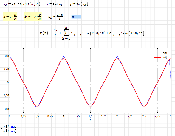

#44 Опубликовано: 27.01.2019 05:23:49
With numeric optimization (for all functions) it works much faster.
Fourier series coefficients.sm (17,54 КиБ) скачан 1681 раз(а).
Fourier series coefficients.pdf (138,41 КиБ) скачан 979 раз(а).
Radovan Omorjan 27.01.2019 08:19:00, Davide Carpi 27.01.2019 07:53:00, frapuano 27.01.2019 08:21:00, NDTM Amarasekera 27.01.2019 09:47:00

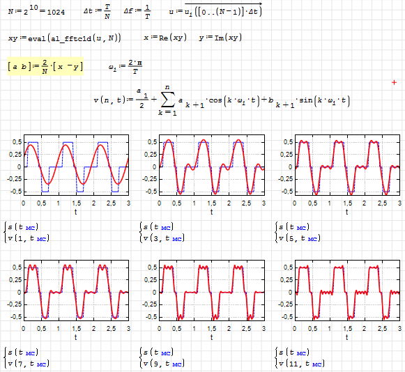

#45 Опубликовано: 27.01.2019 10:59:21
Example 2.
Fourier series coefficients.sm (28,46 КиБ) скачан 1814 раз(а).
Fourier series coefficients.pdf (170,26 КиБ) скачан 1133 раз(а).
sergio 27.01.2019 13:29:00
#46 Опубликовано: 27.01.2019 12:48:06
Otherwise w/o Algib and more Engineering applications
Fourier Budapest39 Smoothing.sm (47,67 КиБ) скачан 1726 раз(а).
#47 Опубликовано: 27.01.2019 13:06:32
Fourier-Fejer-Lanczos interesting too.
IrfanView "ResizeResample" zoom up/down in two options
Fourier or Lanczos the best.
Fourier Fejer Lanczos.sm (9,11 КиБ) скачан 1625 раз(а).

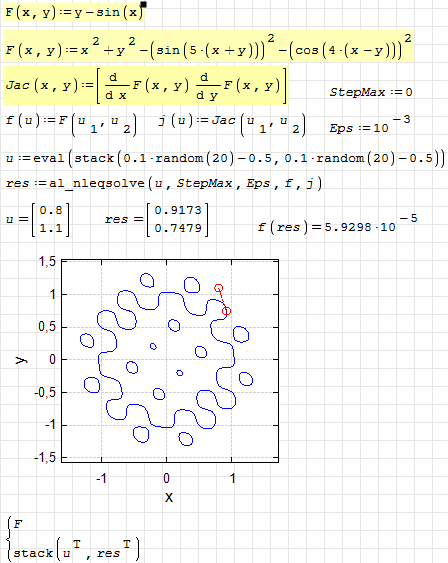

#48 Опубликовано: 18.02.2019 05:42:17
Fridel Selitsky
Fridel Selitsky
Parameterization of implicit functions with al_nleqsolve
Parametrisation.sm (29,88 КиБ) скачан 1720 раз(а).
NDTM Amarasekera 18.02.2019 11:46:00, frapuano 18.02.2019 09:08:00, Alvaro 18.02.2019 14:00:00, Вячеслав Мезенцев 18.02.2019 17:50:00
#49 Опубликовано: 18.02.2019 13:59:33
Hi Ber. Nice technique, easy to implement. You can also make that as a function, and monocolor too.
Parametrisation.sm (25,37 КиБ) скачан 1656 раз(а).
Another option could be use y0 as vector, and solve for each element in y0, obtaining res, res1, ..., resn
Fridel Selitsky 18.02.2019 14:44:00
#50 Опубликовано: 18.02.2019 23:53:03
1. SS 6179 does not complain
2. Takes ~ 1 hr to terminate the first function
3. NO plot result [NO complain but NO plot ?]
4. Would be interesting checking if the attached SS 6179
runs in your actual AlgLib 3.1x. If NOT => would be a dramatic bug.
It would indicate that all maths based al_nleqsolve would be scrap.
Contour SOLVE [Electron Solve algo Express].sm (20,66 КиБ) скачан 1463 раз(а).
