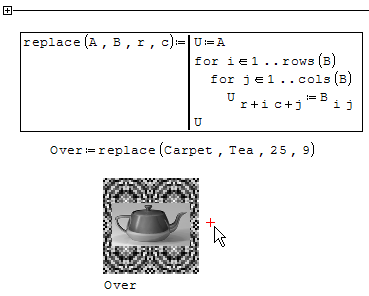

Hi Jean, allow me to be frank here.
It is very clear that image region is not useful much to you. Myself, and at least a couple of other people use it all the time at work, i.e. it is not "dead in the water".
I would not benefit much from overlaying a tiny teapot over a tiny persian carpet. Unfortunately use of large files is limited by the speed of matrix operations in SMath when you have 10's of the in one document, and I do.
Can we just leave it at that? This plugin is useful for some but not all..

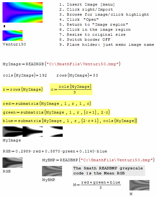

#38 Опубликовано: 17.04.2016 11:07:11
Please excuse me if this has been discussed already.
Is it possible to extend the plugin to accept matrices of 3(4)-numbers matrices (vectors/rows), where members are R, G, B (and optional Alpha)? And maybe functions to read to this structure / write it to image?
In other words, you are asking for an RGB image region, something like the Mathcad
"Picture Operator". I found no independent tool from the web that would do same.
The Mthcad "PicOp" allows lot of useful manipulations: various color scheme, extract selected region from the image... Are you familiar with the Mathcad "PicOp" ?
That's all what I understand from Smath 5346

#40 Опубликовано: 17.04.2016 11:23:55
In short: Smath Image region does not read color image, it "Imports" [nuance].
Once in work sheet, "Image region" does 0 processing by itself.
From external user processing, you can:
1. replace part of image
2. zoom Fourier small image [zoom up 2]
3. vetorise for light intensity.
4. mirror image, rotate +/- 90° by matrix manipulation
5. scale overal image to user grayscale.
6. what else ... extract band valued pixels, specific valued [locate]
7. more specific vetorise to highlight contour region.
..... Jean
