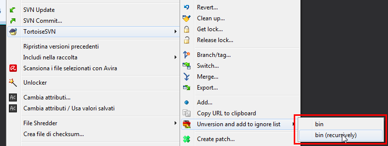

- removed bin and obj folders (you can add these windows folders to the ignore list, so you can avoid to commit them unintentionally);

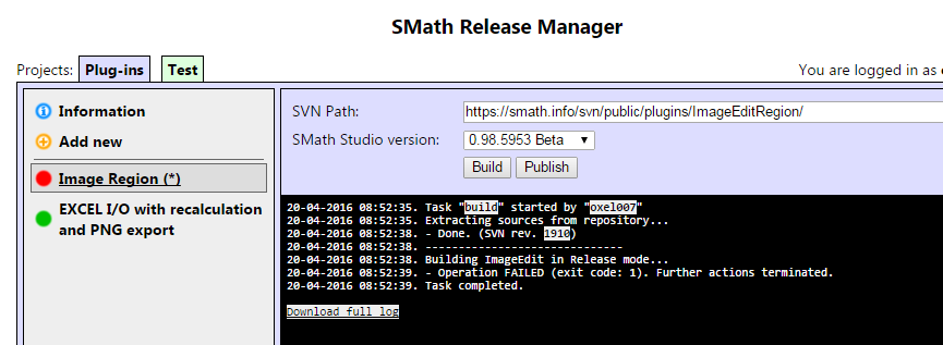

Davide, the tweaks you made still do not allow me to build the plugin using
http://smath.info/ReleaseManager/
(same errors as in previous log)
Are you saying it works for you? Is it something to contact Andrey about?

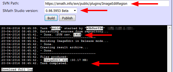

#57 Опубликовано: 20.04.2016 12:49:06
I confirm it works for me... which is the target version you are using?
#58 Опубликовано: 20.04.2016 12:56:00
Alexander O. Melnik
Alexander O. Melnik
Fails for me
report.log.txt (38,5 КиБ) скачан 1331 раз(а).
Time to contact Andrey.

Fails for me
I think you are right...
warning MSB3245: Could not resolve this reference. Could not locate the assembly "SMath.Controls". Check to make sure the assembly exists on disk. If this reference is required by your code, you may get compilation errors. [{SourcesDir}\ImageEdit.csproj]
Since I don't know how it works the RM, I can only suppose that there is some sort of "cache effect" for your account because previously you have compiled the plugin with the old APIs (?)...
Also how do I use Entry instead of Term? Will it make working with RGBA matrix faster?
It may worth the effort, since images are made of a lot of data (you have to change just one thing - but actually I have no idea how to convert base.Terms to an Entry); just to mention, if you use it, the updates for SS versions < 0.98 are a little bit more difficult to provide (since you have to change the code).
#60 Опубликовано: 20.04.2016 18:12:42
Error discovered in Release Manager. It is fixed now.
Please try to build plug-in again.
Best regards!
