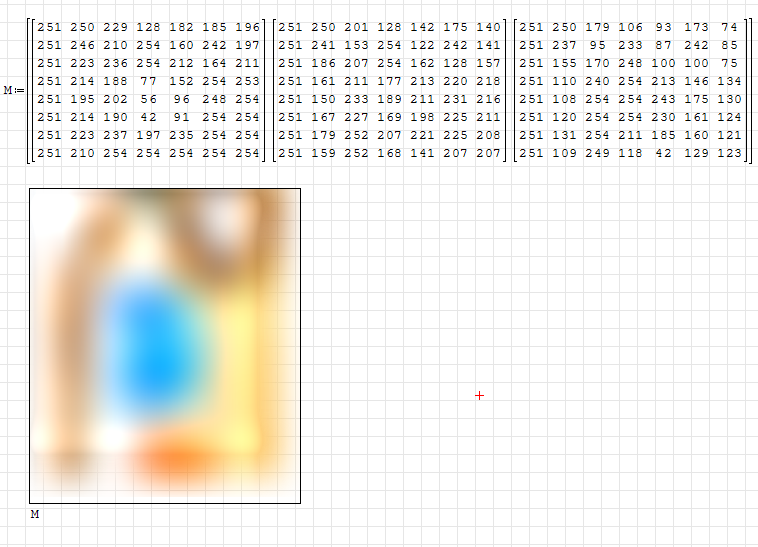

Alex, can you see this matrix in the image region?
mat(mat(251,250,229,128,182,185,196,251,246,210,254,160,242,197,251,223,236,254,212,164,211,251,214,188,77,152,254,253,251,195,202,56,96,248,254,251,214,190,42,91,254,254,251,223,237,197,235,254,254,251,210,254,254,254,254,254,8,7),mat(251,250,201,128,142,175,140,251,241,153,254,122,242,141,251,186,207,254,162,128,157,251,161,211,177,213,220,218,251,150,233,189,211,231,216,251,167,227,169,198,225,211,251,179,252,207,221,225,208,251,159,252,168,141,207,207,8,7),mat(251,250,179,106,93,173,74,251,237,95,233,87,242,85,251,155,170,248,100,100,75,251,110,240,254,213,146,134,251,108,254,254,243,175,130,251,120,254,254,230,161,124,251,131,254,211,185,160,121,251,109,249,118,42,129,123,8,7),1,3)
#72 Опубликовано: 16.05.2016 14:58:59
Alexander O. Melnik
Alexander O. Melnik
Hope its not one of those hard to trace bugs that are hardware / OS dependent
M.render.sm (8,55 КиБ) скачан 1417 раз(а).
#73 Опубликовано: 16.05.2016 15:29:20
Thank you! Solved, seems I was having a newer version installed (?)
Uninstalled and downloaded again, now it works :d

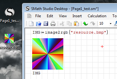

#76 Опубликовано: 17.05.2016 08:03:34
Using latest Nightly Build of SMath Studio and the last beta of Custom Functions.
Alex, can you make the double-click feature enabled just on the canvas of the region? It is really annoying while trying to edit the math content

#78 Опубликовано: 17.05.2016 12:24:25
Could you please provide an example? I have just opened my balloon test file and nothing happens if I double click anywhere on the region.. as it should be.
Not sure what happened... while editing the file for posting the screenshots the default viewer was launched several times, now I'm no more able to reproduce. Don't worry, if it will happens again I'll try to find the way to reproduce it.
