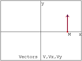

Kinematics of a Moving Point
Davide Carpi 12.11.2012 07:19:00
