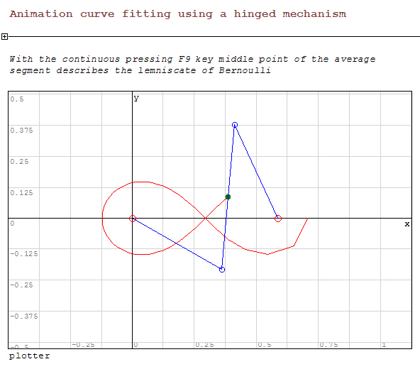

#1 Posted: 11/5/2010 6:39:20 PM
2,343 likes in 4,043 posts.
Title: Animation curve fitting using a hinged mechanism.
Author: Fridel Selitsky
Download: Lemniscate_mod.sm.
Radovan Omorjan 11/6/2010 8:53:00 AM, Oscar Campo 11/8/2010 3:05:00 PM, Davide Carpi 10/1/2012 5:58:00 PM
#2 Posted: 11/6/2010 8:54:39 AM
Hello Andrey ,
Nice example of how to simulate an animation using rfile, wfile and F9.

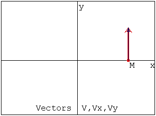

#19 Posted: 11/12/2012 12:34:23 AM
Kinematics of a Moving Point
Davide Carpi 11/12/2012 7:19:00 AM
