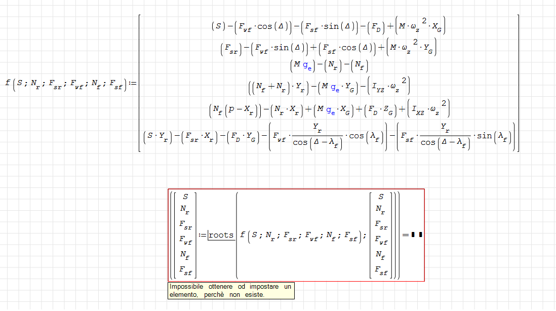

I am having difficulty solving a linear system like in the picture.
the error says:"impossible to get or set an item because it does not exist"
does anyone know where the error can be and how to solve this problem?
Thanks in advance
#2 Опубликовано: 05.11.2019 15:08:12
"roots" does not work with the units. You must adimensionare equations, or you can try the other features present in the plugin (eg "FindRoot" present "Nonlinear solvers" plugin)

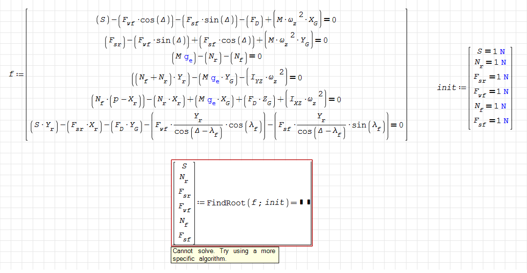

I tried another function but it still gives me an error...
#4 Опубликовано: 05.11.2019 23:57:28
It's a huge system, and generally does not accept all initials same.
I would zap units first. This kind of solving should have it be
solved from P & P [Pain & Prestige] as it reflects real project
that does come out of the blue. Even Mathcad Given/Find may fail
or pedal through constrain.
Attach the work sheet ... some source reference as well.

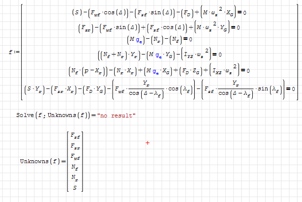

Equations 3 and 4 probably demand different values for N.r+N.f So there is no solution.
If the system has a solution, the function Solve() from Maxima plugin might find it.

1. equalities [1,2,3] are consistant 'N'
2. equalities [4,5,6] are inconsistant 'mixed units'
calcoli.sm (52,58 КиБ) скачан 1053 раз(а).
You must make the system consitant before attempting solve.

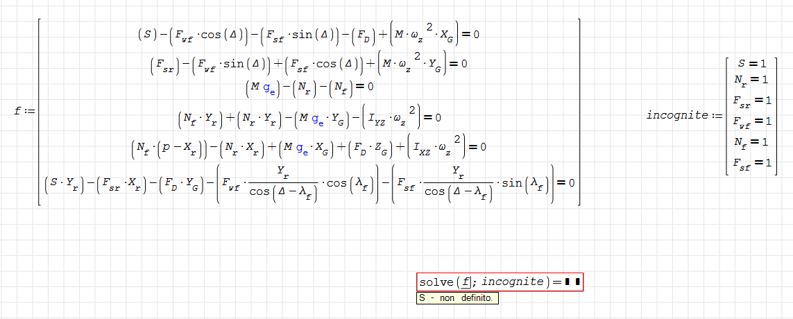

I tried to use the solve function but it still gives me an error saying that S is not defined
#9 Опубликовано: 06.11.2019 15:47:31
Did you read my reply just before your visit ?

Hi. Try this setup, using al_ library. I don't know if using better guess values can get better results (eqn 3 and 4 don't get good results)

Hi, thanks for the reply, but I think I found the error. The system I wrote has two linearly dependent equations, and for this reason it cannot find a solution.
I will have to modify the whole problem.
