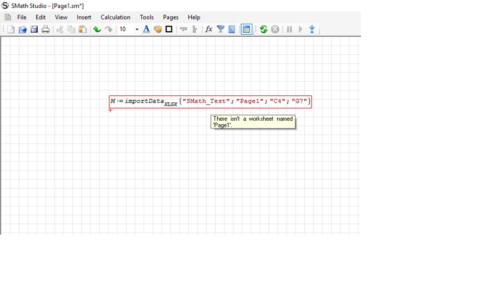

I still don´t get the way how to import xlsx files into SMath files.
It seems, that the xlsx file is found, but there is an error, which sais
my SMath file doesn´t exist.
Would be happy about your help.
Thanks.
G-Tate
#5 Опубликовано: 22.10.2018 12:31:54
Alvaro Diaz Falconi
Alvaro Diaz Falconi
1 076 сообщений из 1 748 понравились пользователям.
Hi Tate. The word unavaible "Page1" worksheet isn't about a SMath file, it's about a "Page1" worksheet in the "Excel workbook" named "SMath_Test" (without extension), which I guess that don't exist too (because the name of the Excel file requires the extension, not only the name).

Try to add the ending to the filname .xlsx and check if Page1 exists
Seems to be that Page1 is not there in the file

If you don't give an extension xlsx is assumed as default; as pointed out by Alvaro and Stefan you have to check if the the worksheet exists in the file
excel workbook = the whole file
excel worksheet = each single tab in the file

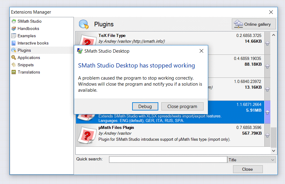

14 сообщений из 97 понравились пользователям.
Hello Davide,
The plugin doesn't work with the latest Smath beta.
It crashes right away during plugin installation:
I tried it in office on Win10 and at home on Win 7,
all the same. I'm using 32-bit SS on 64-bit Windows.

#9 Опубликовано: 24.10.2018 12:54:08
1 434 сообщений из 2 912 понравились пользователям.
Thank you, confirmed.
Latest release deleted.

Gowand Gravi
Gowand Gravi
0 сообщений из 22 понравились пользователям.
Thank you very much guys!
I didnt get, that the second name needs to be the sheet name from the excel workbook.
I just tried it with the smath file name.
I should´ve think about it, that the import anyway goes to the actual smath file.
