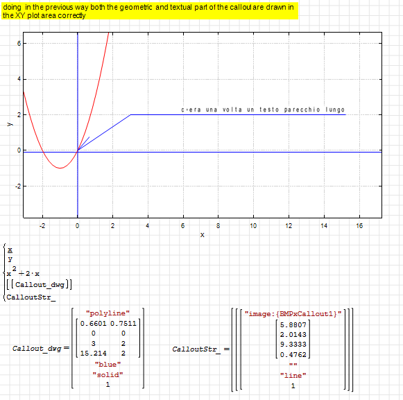

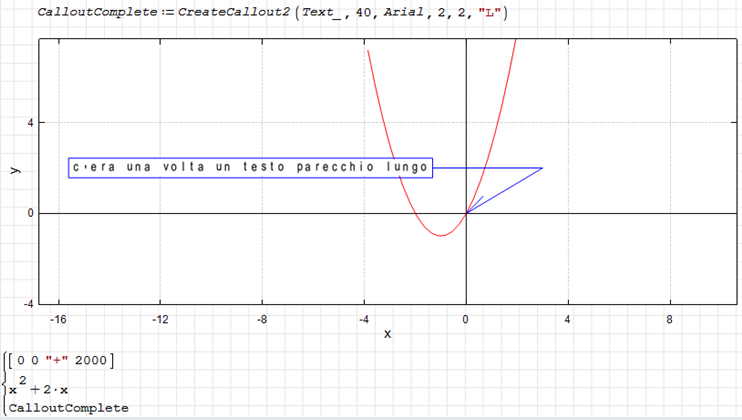

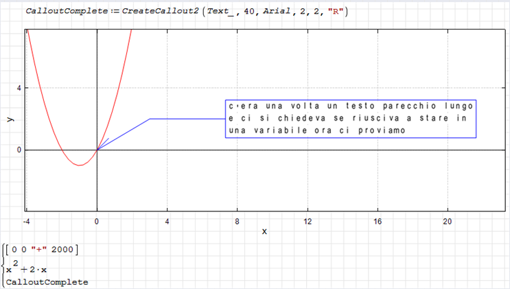

I am going ahead in the Callout project but I have reached a critical point and I am struggling hard ..but do not find a possibility to progress and complete it as I would like.
I was able to create the callout drawing, to word wrap the text in different rows and to convert the rows in BMP strings and to store them in a vertical array ( Alvaro I didn't create a block with all these rows merged togheter as in your program I decided to keep them split ) .
Now i need to apply the instructions to draw them in the XY Plot Region ...and here comes the troubles.
I am not able to create a loop to do this because in this type of instruction :
the image file/name ( i.e. "image:{BMPxCallout1}" )can't be retrived from an array of images and I can't write directly "el(TxtxCallout,i_rows)" , (sorry but I don't know how to write the corresponding indexed variable in this post so I left the internal representation ) but I need to transit through the assigment of that element to a variable not indexed.
I am running through the posts related to creating traces in a loop from Oscar and Martin ..but I am not able to cume up with a solution/workaround .
Any suggestion will be highly appreciated; thanks in advance for any help, take care and best regards.

Herewith the files I am working actually, you can see the terrible ways used to draw/test something

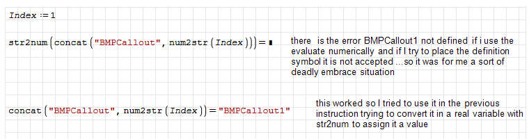

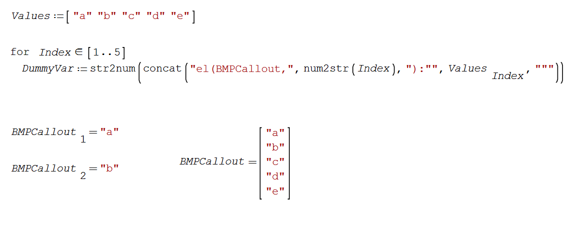

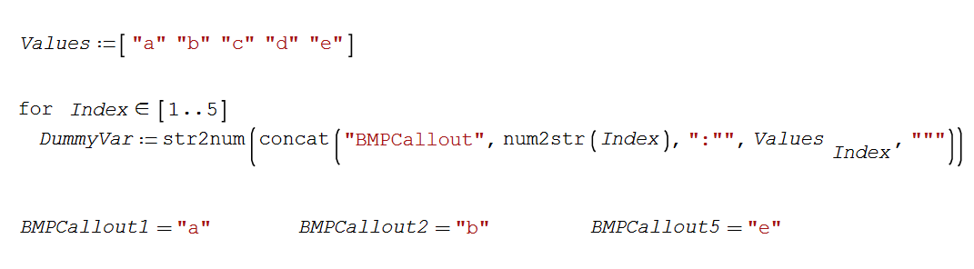

Wrote... to create a variable name (continuouly changing with an index) on the left side of an assignment expression and assign to it the content of an indexed variable...
Franco
Hi Franco, for assign values to indexed variables you need to use the function el(VECTOR,INDEX) which references an element of a VECTOR by its INDEX. Further steps is management of strings to num and viceversa:
in This Way you will have a Vector called BMPCallout with many indexes as you want and each element has assigned a value.
Another way is to create individual variables ( BMPCallout1, BMPCallout2, ... ) in this way:
on each case, the DummyVar is neccessary to evaluate the conversions between strings and numbers
Best,
Oscar

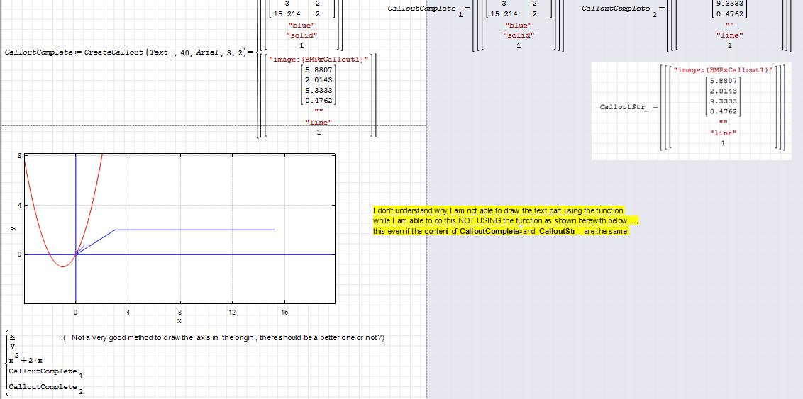

are many weeks that I am going ahead to complete the Callout project , I was able to position correctly the text on both type of Callout I am working on for now ; the one where I place directly the text above and/or below the Callout orizontal line and the other one where the text is enclosed in a rectangle drawn at the end of the Callout orizontal line.
I have placed some limits to te drawing possibilities (i.e. the maximum number of the callout text rows is 8 now).
The only problem that I am struggling to resolve since many weeks is that I am not able to pack all the functions that I have developed in a final container function that i have called CreateCallout.
The only thing I am sure about is that it must be a very stupid thing that I am missing but have done all the possible attempt to understand without succeeding and I have lost mental clarity for further investigation ( I have read several time the document from Davide too , that is really super-detailed about user defined functions ).
Please can you give a look -when you have time- to the attached worksheet to see were I am wrong ?

Hi Franco. I guess that the problem is that the image tag {img} must be at the worksheet level. Please check the note at the right margin in the file from this post: https://en.smath.com/forum/yaf_postsm86128_X-Y-Plot-Region.aspx#post86128
Images are matrices. You can unlink them from the file showing the matrices with an evaluation, x = ..., expanding the view to the entire matrix, and making a further assignation with x : ... with the most valuable code in windows: copy and paste.

Finally I have a time to check your file and here are the answers and solutions to your questions.
In the attached file...
1. I explain how to obtain the "Arial Matrix" using the magical recipe "copy and paste" :d
2. How to deal with local variable defined inside a function and pass it to the "worksheet level" (as mention Alvaro)
All my answers and commentaries are in yellow font and black background

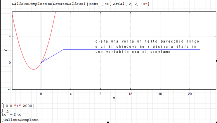

Thanks again Oscar for your answer and for all the details in your explanation. I really appreciate.
I try now to describe what I guess I have understood for your confirmation.
It is clear that when a variable is created in a user defined function it is not available outside the function itself ( except if it is one of the outputs of the function itself ).
It exists only whithin the function and I can use it in the function to create other variables and this is what happens when i create the variable dummy and the one used as an output of the function CreateCallout i.e. CalloutStr.
The critical part is in CalloutStr if I check its contents I see that it is equal to the content of the variable generated NOT using a function; this means that in this last variable to the symbolic variable name BMPxCallout1 are however linked real data ( the BMP matrix ) while for the variable CalloutStr ( output of the function ) to the variable name BMPxCallout1 is NOT replaced at runtime the real data that are behind its name and to renable this link I need to read the data from an external file where previously I have saved it ( and obviously the reading instruction MUST be outside the function itself ) at the worksheet level)
...Am I a little bit close to what is happening or as usually I have understood nothing ?

Ok Franco. You are getting the idea.
Te best way to understand and realize things like those ones is read the documentation and stay alert to this forum. There are many interesting topics and discussions and you can learn new things from people working on different problems and projects.
In fact, some monts ago I learned another way to redefine worksheet vars from functions, (please check this post)
So when you apply this technique you can solve your problem in a more elegant way, as I show in the following file.

Jesus help me,
Oscar I have seen yesterday just the top part of your answer in the file you attached but probably have problem with my sight/concentration and I didn't notice the + at the level of the function definition ... so I was wondering about what you were meaning with definition , ecc, ecc and output when you define a function; this is what I thought I had already done previously.
Only after enlarging the picture in the message of Kenny and reading other 5-6 times all the thread and your last workseet for the n-th time I have finally understood ...this morning better late than never ( probably this morning my brain is switched on and hopefully will remain in this status for few hours and I have to take advantage of it)

Oscar Campo 25.01.2025 20:55:00
Hi Team,
after a long time I guess that I was able to develop a 1st release of the Callot project that I attach herewith. XYPlot - Callout_with_Scalable monospaced BMP fonts_Ver1.sm (1,78 МиБ) скачан 1847 раз(а).
I hope that this can be of any help for someone who needs to add callouts to drawings.
The shape of this release is not what I would like and I plan to add the following:
0-Add the trasparency in each row of text as shown in an Alvaro's example about this issue.
1-Add the BMP fonts available in the file of Alvaro and some additional ones similar to the style of a text in Autocad (need to check where I can find them because there aren't in Excel)
2-Check if make sense do not introduce the coordinate of the arrow part of the callout as arguments of the final function used for their drawing ( I guess that is not a very good idea )
3-Moreover I would like to minimize the Inputs for the creation of a callot using the method seen in some examples from UNI related to Shapes drawing ( basically defining defaults that can optimize the graphical look of the callout so that if some inputs are missing these defaults are used )
Again I would like to acknowledge the enormous help of Alvaro and Oscar who with their examples and suggestions allowed me to move forward with this project(probably the word project is too important for what I did that is something very modest).
Last thing is related to the copy and past technique use to store a font matrix ( or other data ) in a worksheet avoiding to retrive these data each time from an external data file.
Now the procedure explained works ..but not in a nice way ; I mean that if I have a huge matrix of data read from an external Excel file for instance I see that this matrix is displayed with 3 dots at the bottom that allow to see the matrix in a collapsed way . The problem rises when I want to copy the content of this matrix in another variable . First this is NOT possible if I don't expand all the matrix so that I can see and select ALL the data that are stored in it . Second most annoying thing is that after the copy and past in the new storage variable it is no more possible to collapse the structure of the matrix using the 3 dots and I must see it as a whole forever .
My personal opinion is that this behaviour is not correct and that it is very similar to a bug.
For what concern the callout function I am obviosly available for any suggestion for improvements and to critics or requests for clarification ( I tried to document as much as possible the main variables/parameters used but this was based on my personal point of view )
Franco

have attached herewith a new release of the create callout functions where I tried to add the features described in my previous post, so:
0-Add the trasparency effect to the text placed on the XY area using the Alvaro's method (which I call "Ink jet" method). This is a very interesting and intelligent technique in which only non-white pixels are displayed but applying it to a long text string has been proven to be unfeasible because the worksheet execution times increase too much.

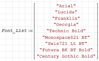

1-Add more fonts from the Alvaro's file and some additional ones with a "Technic" style.It is now possible to select a font from the 9 ones listed herewith.
the files (.png) with each font data are zipped here FontsDataFile.zip (44,94 КиБ) скачан 575 раз(а). and each font can be selected in the worksheet in this way
These files must be unzipped into a directory along with the following workseet XYPlot - Callout_with_Scalable monospaced BMP fonts_Ver1_3S.sm (2,26 МиБ) скачан 1842 раз(а)..
It has not been possible to embed the content of all these external files in the worksheet ( as initially desired ) because again its execution times increase too much.
2-Adding the coordinate of the arrow part of the callout as arguments of the final function used for their drawing . Done
3-Moreover I would like to minimize the Inputs for the creation of a callot using the method seen in some examples from UNI related to Shapes drawing ( basically defining in this way a set of default arguments that can optimize the graphical look of the callout itself and speedup its creation ). Done

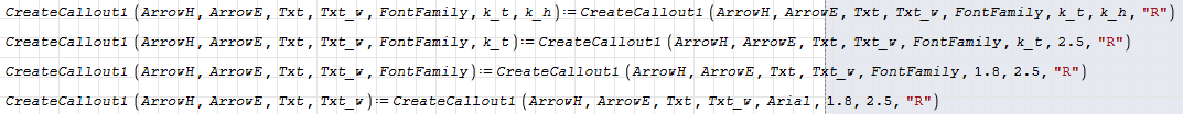

For what concern this last point I have the following question. Is it possible in a user defined function that has for instance 7 arguments ( see herewith what I have done for the CreateCallout function in the worksheet attached )
define a default in a central position but NOT beeing obliged to accept already all the defaults related to the arguments at its right ??
I mean if I wonna define that the default just for the argument FontFamily is Arial and for all the other arguments at its right I am free to place whatever I want; how can I write the expression of the user function ?
Or this is not possible to accomplish and simply I must define in the function body at the beginning (usually) that if the argument of FontFamily is "-" or something else that I have pre-defined in advance and that means a default value for the argument in that position I will consider Arial as the FontFamily passed value . Hope that I was able to explain this issue quite well .
Thanks in advance for any help and best regards
Franco
P.S. Herewith some usage examples, they aren't done with the last release of the worksheet, other examples screenshot are in an area at the bottom part of the worksheet
