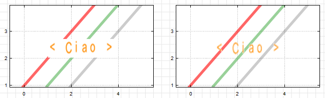

As stated in the subject I have developed a little function to create a simple callout to use as a pinpoint tool in a XY Plot Region graph.
It cames after several weeks of analyzing the history of the development of the XY Plot plugin from UNI; all this in the hope of understanding better how to use it and to minimize the possibility to get lost in the examples that I see recently published in the forum .
During the development of this small program there have been several issues to address and strange behaviours ( at least for me ) that have experienced but this will be the subject of a future mail (probably).
In the attached file have summarized many info's too distribuited in the posts and in the Martin's Reference Book so there is a little bit of documentation redundancy and I apologize in advance for this.
Moreover during the usage of the Shape functions I have had the illusion to understand something and I have written this down in some comments , I will be more than pleased if you can correct them if you feel that some of them are not correct .
The aim is always that of learning something more every day so thanks in advance for this .
There is however one thing that make me wonder and I would like to ask to UNI or anyone that is able to answer and is why it is not possible to place the output of a Shape function in the XY Plot placeholder directly but it is needed to place it in a (double ?) nested matrix otherwise the XY Plot Interpreter ( sorry fot the inappropriate name of the routine that I guess parse the string(s) of command written there ) is not able to understand correctly the plot request.
Franco

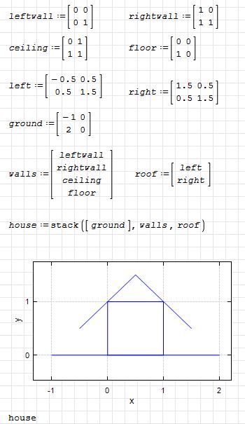

This is not a double nested matrix, but sequences from groups of objects in the form of shapes. This form of representation was chosen to build complex vector drawings from groups as one trace.
The usual nested poly line is similarly arranged, you can set several coordinate sets in the form of one nested matrix.
Many users do not use the grouping of sets from many shapes, so it is not clear to them why so many nested matrices.
An additional reason is to simplify the analysis of different data formats for the component. Data formats should not intersect during interpretation, causing ambiguity.
You can offer your own format, but you should think about how to maintain all other capabilities of the component.

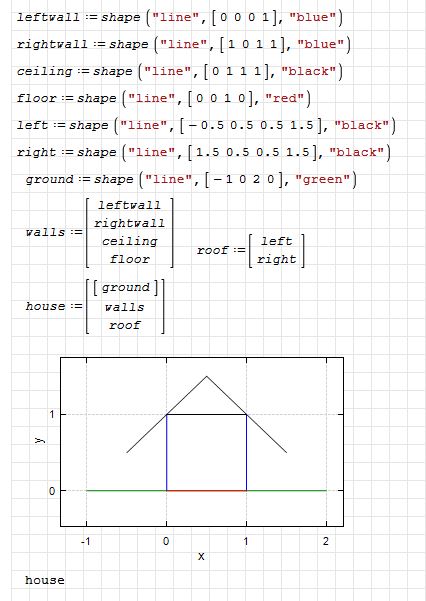

An example of using a set of objects. As you can see, when used this way, the nested matrices are not so noticeable.
Oscar Campo 04.12.2024 21:34:00, francesco rapuano 04.12.2024 22:57:00, Alvaro 05.12.2024 21:06:00

The same for polyline.
xyplot-polyline-house.sm (8,37 КиБ) скачан 1534 раз(а).
xyplot-shapes-house.sm (11,72 КиБ) скачан 1583 раз(а).
francesco rapuano 06.12.2024 19:45:00

Very interesting these examples, mainly the last one that shed further light on the internal workings of the XY Plot plugin ( the polyline function ).

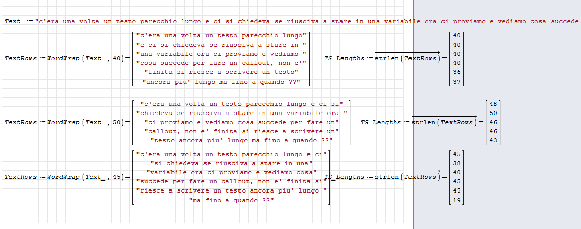

Hi Uni,
I am going ahead with the routine to draw a Callout and I have developed in the meantime a small function for the word wrapping of a long text stringXYPlot Word Wrap Tests.sm (21,4 КиБ) скачан 1577 раз(а).
Now I would like to merge this function with the other one that draw the Callout arrow but to accomplish this I need to position vertically the substrings of text that are the output of the WordWrap function; so come out quite naturally the following questions:
1-When you define that the font of a text label is Arial10pt what does it means as a vertical dimension and which is the vertical and horizontal dimension of a letter Arial10pt
2-Which is the relationship - if exists - of the previous vertical dimension with the numbers that I use to specify the position of the label on the xy plane of a plot ( the coordinates where I place the text label) , Is it something with similar units ( which units? )
In the event of having these information probably I'll be able to position the substring of text correctly in the xy plane avoiding their overlapping and moreover I'll be able to evaluate the maximum horizontal length of each substring and define a correct size for a rectangle that will be the border of all the Callout text.
I hope that I was able to explain my concerns and that someone will have suggestions about the points above reported.
Thanks in advance to anyone and best regards
Franco

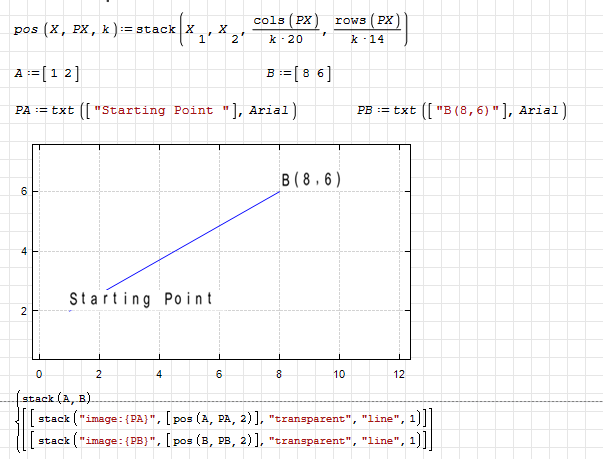

Hi Alvaro,Oscar,
sorry for disturbing you but I would like to know if it is possible to draw the string of BMP text on the XY Plot Plugin but with a transparent background, as you can imagine going ahead with the project of drawing Callouts rise the problem to have a text that allows to see the background graph or whatsever is in the background otherwise I guess that we lose clarity in what we highlight through the Callout.
I know that BMP doesn't allow a transparent channel ( or not ? ) we should move probably to a PNG format and probably I would be able to save in PNG with a transparent background the font matrix that now are in BNP format but the possibility of the XY Plot Plugin will allow to draw/show images/picture in PNG format with transparency ?
I hope I was able to describe the problem decently.
Thanks in advance for your help and best regards.
Franco
P.S:Herewith we see that the text "Starting point" hide a little bit the starting of the line segment , obviously I have inverted the display order sequence despite the original Alvaro's file to show this.

Hi Franco. At this moment I think the XYPlot plugin supports only one matrix with the grayscale from 0 to 255 or three matrices with the colors [R G B], but not transparencies, to represent images. However, I am not sure and that is something Viacheslav can answer.

Hi. A workaround.
XYPlot - Scalable monospaced bitmapped fonts COLOR.sm (2,17 МиБ) скачан 1761 раз(а).
