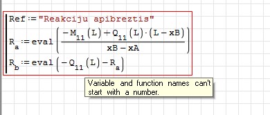

Hello, could somebody help me. I don't understand how to solwe this problem.
