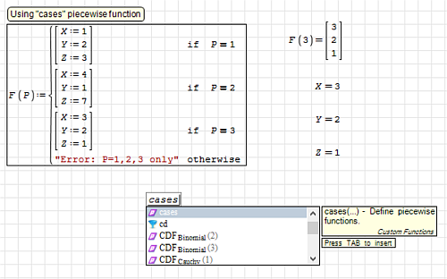

NDTM Amarasekera
NDTM Amarasekera
Using "cases" function.
cases_ex.sm (89,06 КиБ) скачан 948 раз(а).

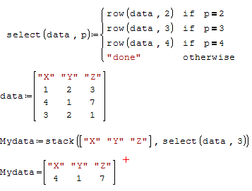

#6 Опубликовано: 30.04.2020 11:25:14
haweHofmann
haweHofmann
3 сообщений из 32 понравились пользователям.
If you want to use the variable names X,Y,Z
a simple
data:mat(1,4,3,2,1,2,3,7,1,3,3)
mat(X,Y,Z,3,1):col(data,p)
will do the job.
you can also use a vector XYZ
XYZ:el(data,range(1,3),p)
and its components i=1..3
el(XYZ,i)
copy code to sheet
