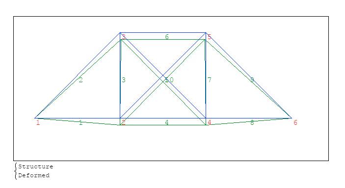

Here is FEMTRuss, my own version of truss calculus via FEM.
I'll check your work, please you check mine
FEMTruss.sm (49,06 КиБ) скачан 1441 раз(а).

So far results look good. Great work!

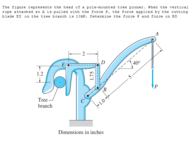

A little example solved by FEM...
P4-118 Pytel modified.sm (165,01 КиБ) скачан 1418 раз(а).
