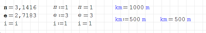

1. I confirm the problem of accessing Tools> Options.
It can be avoided by setting the option "representation" to "Default" instead of "Initial" manually by editing the settings file. Then you can switch as usual between the formatting options.
2. Following the logic of "Default" formatting, all pre-defined stuff is non-italic and all user defined functions and variables are italic, user defined units still are upright.
Therefore, it would be sufficient to display the pre-defined values π and e in normal upright. Yet they show up in bold.
On the other hand, the imaginary unit is not bold and is not displayed italic if re-defined by the user.
Proposals:
- Just let π and e be upright to show that they are pre-defined.
- Make i italic as soon as it is overwritten.
- Make user-defined units italic.

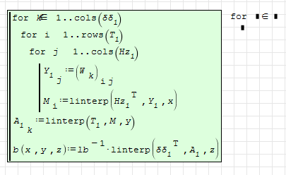

#44 Posted: 11/22/2017 5:07:57 AM
1,443 likes in 2,935 posts.
another issue in nested for()
and in math text (text cursor is displayed in the wrong position)

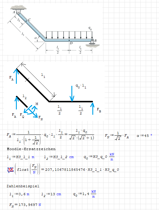

#45 Posted: 11/28/2017 7:52:04 PM
Yet another issue: The formatting for un-evaluated math regions doesn't obey the representation settings. This leads to different format of single variable names as used for image annotation (non-italic) and the same names in evaluated math regions (italic).
H3_Balken_mit_Knick.sm (124.39 KiB) downloaded 1650 time(s).

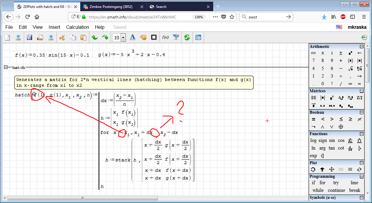

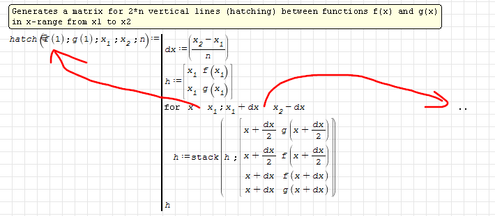

#46 Posted: 11/29/2017 5:41:18 AM
Here not only the "in" operator but also the range dots gets lost. The example is taken from https://en.smath.info/view/hatchandfill/summary
cloud:
2017-11-29 09_15_57-2DPlots with hatch and fill - SMath Studio in the Cloud.png
installed app:
2017-11-29 09_31_48-SMath Studio 0.98.6528 - [2DPlots with hatch and fill.sm_].png

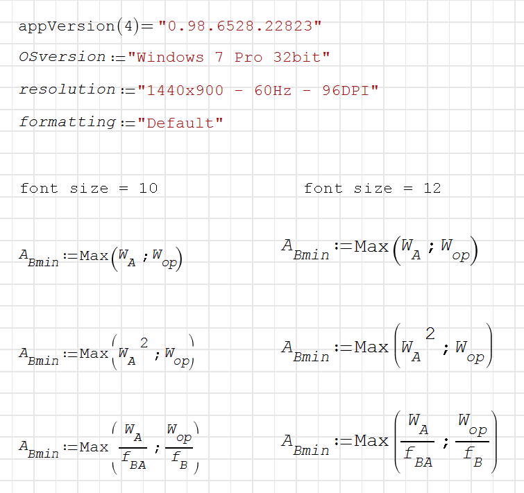

Anyone else reproduce this paranthesis issue, or is specific to my machine?
I uninstalled and deleted every footsteps of Smath before installing the latest release.
As far as my tests, not occured on my home PC which is Windows 10 x64 and 2K resolution. Happens at work computer.

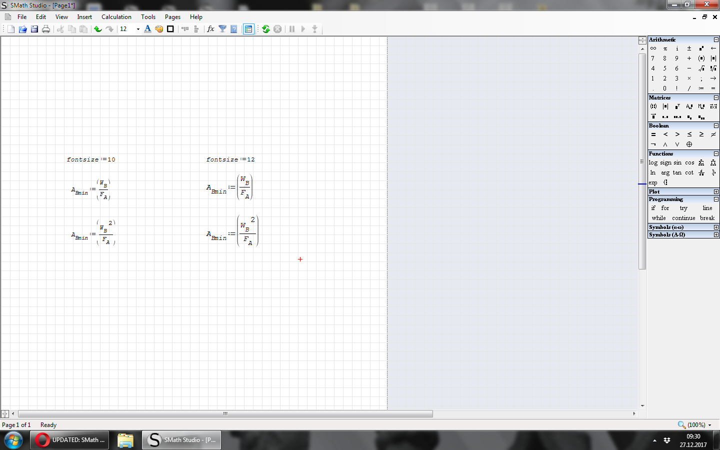

#48 Posted: 12/22/2017 5:05:23 PM
Igor Skarine
Igor Skarine
14 likes in 97 posts.
Yes, I do have the same issue on different computers win7-64 and win10-64.
Old Win7 display is not high DPI at all, I just used 125% custom font size.
The right picture is created by old Smath version.

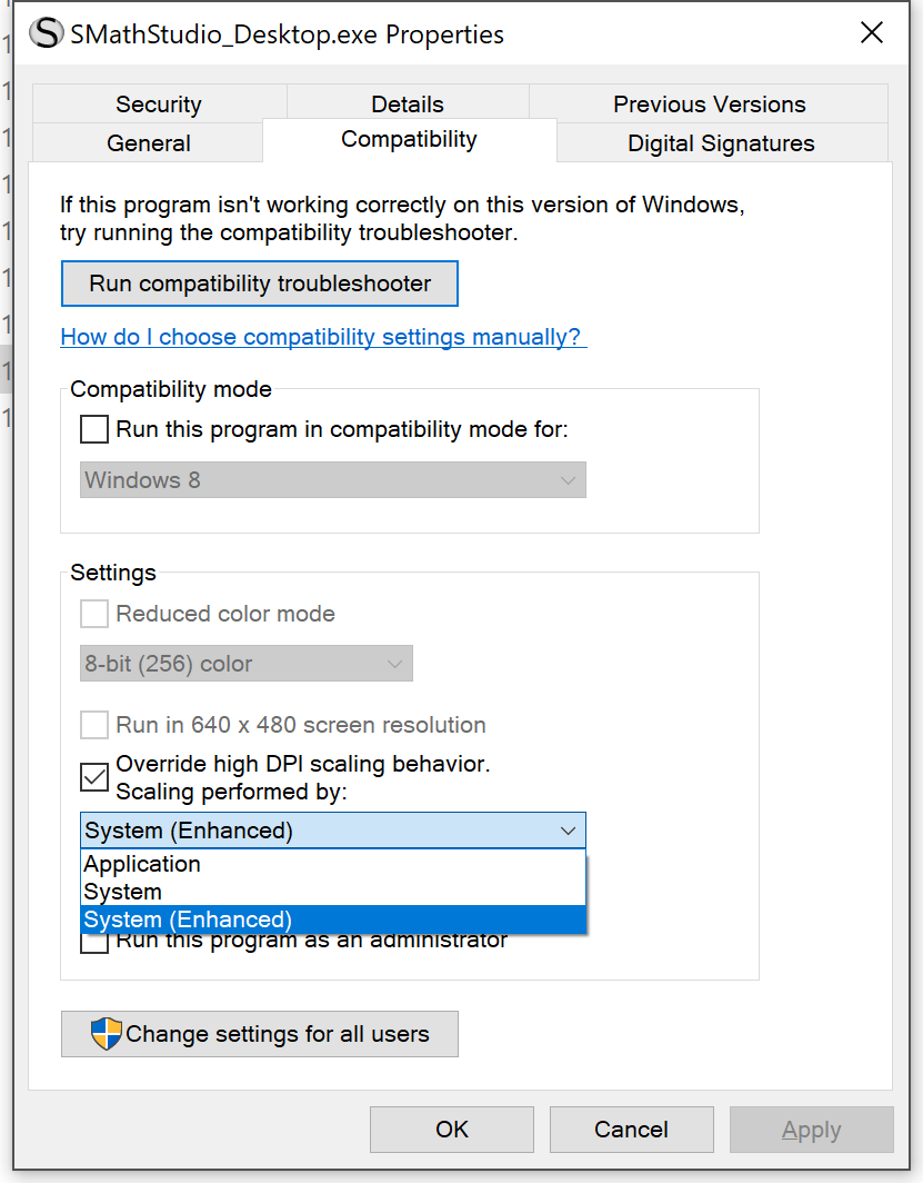

#49 Posted: 12/23/2017 3:27:39 PM
A reader of my SMath Handbuch sent me a hint on how to handle high DPI problems under Win10. I can't test this but would be interested in feedback whether this is helpful.
You don't precise if same machines home/work and same versions and both auto-mode update.
Your work sheet [if your snippet is 1/1] is in unreasonable zoom, that may matter wrt Win version.
The small laptop Win 7, once a work sheet has been zoomed up, the reverse zoom down is possible,
but NOT back to original default, i.e: not returned 1/1 original.
This type of zoom is just an upscale, which is not reversible. All that to say that increasing
the font size looks compatible. If you need larger size font in math regions: compose native as
set in "options", then increase from the drop down menu.

598 likes in 1,380 posts.
The picture I shared above is taken at %100 zoom of Smath just by print screen by the way. I have also tried it with %125, %150 and %200 zooming of Smath. This happens whether the page is zoomed or not, zooming the page is not the issue here.
With exactly same settings of Smath on Win10 x64 and Win7 x86 (though they don't have same hardware and resolution), the Smath on Win7 is creating the parenthesis issue. the exact same page doesn't make this when I open it on Win10.
When a text or formula is selected and font sizes are set to 12 on problematic Smath, the phenomenon disappears. It happens when font size is below 12.
My guess is the left and right side of font characters overwrites to parenthesis with lower font size values. But I can't understand why Smath on Win7 is spoiling it and Win10 is not.

Strange, I tried to reproduce on my Win 7 laptop ... can't.
Your snippet is 1/1 print screen of the work sheet, so:
the work sheet is "overzoomed". Just work on native WS.
The brackets are glyphes, maybe not scalable.
Is your Win 7 "real" or a "crack" ?
Did the kids played games ? ...
#53 Posted: 12/25/2017 10:57:28 PM
The native Smath grid is 19 pixels. Your PrintScreen is 32.
At same zoom [32], I can't reproduce your num/den problem WIN 7.

At your zoom 32, the beautiful Smath graph turns horror.

Here is the full screenshot just to make assure you zooming is irrelevant. Notice the zooming is at %100.
#55 Posted: 12/27/2017 1:19:23 PM
0. Tested Win 7 small laptop Smath 6179
1. always crop the capture ... otherwise too big and difficult to reproduce.
2. Try not to use italic
3. @ size 18, Bmin starts touching := but parenthesis are OK
4. If nothing works: re-install your Win 7 from CD
or from the shop that sold you. If your Win 7 is not original, i.e: a crack
or a 2nd hand, maybe can't be doctored.
5. Did you have same problem with previous 6179 ?
If 6179 was OK, try to recover back [Windows facility].
6. If your machine had played illegal games, may be dead/damaged for ever.
Can't help more ... wait for more savant Doctors
#56 Posted: 12/27/2017 1:57:11 PM
That closes the discussions ... 6528 is the problem
