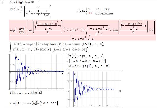

WroteHi, this is a snippet for numerical inverse Laplace transform. You can find time response of a system expressed in F(s) form.
That one was well covered, two last remarks:
1. That Smath does not trig example [1], rather in terms of exp(,)
OK, unfamiliar ... but much faster as it involves only one numerical approximation.
Whatever: it's the Maple business, from which Smath depends upon.
2. last visit [red/cyan[ is sometimes of importance as demonstrated.
InvLaplace2 Otherwise.sm (49.53 KiB) downloaded 1285 time(s).

Hi. Improved version, works faster. Coefficients for the inversion are precalculated outside the inverter caller and avoiding vectorization for more compatibility of the inverter.
InvLaplace3.sm (98.32 KiB) downloaded 1341 time(s).

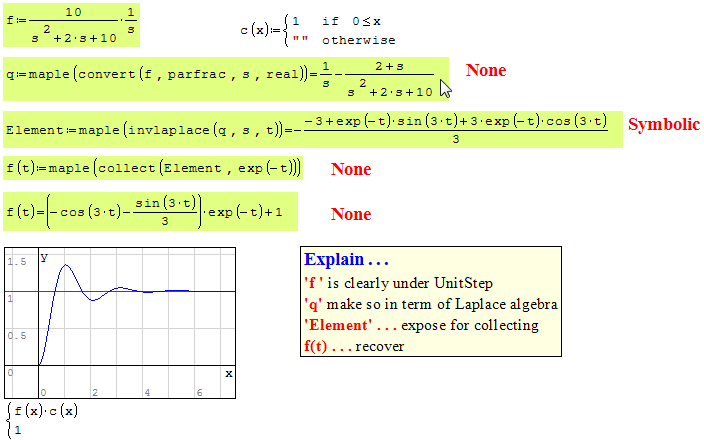

#44 Posted: 3/20/2019 2:01:50 PM
WroteImproved version, works faster.
Thanks Alvaro,
Any real use for this old style inverser,
vs Maple export c/w parameters that works much faster.
Saludos ... Jean
Laplace Maple Parametric Export.sm (15.2 KiB) downloaded 1291 time(s).
