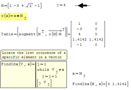

#3 Posted: 5/27/2020 9:03:55 PM
1418 likes in 2874 posts.
Also
(move the equal in the booleans from the leftmost addendum to the rightmost if you don't want to match zeros from the original vector as positive values)

#4 Posted: 5/27/2020 9:56:07 PM
983 likes in 6866 posts.
Truth table in more general, multi purpose.
Utilities Matrix Truth Table [Locate row_col].sm (43 KiB) downloaded 82 time(s).

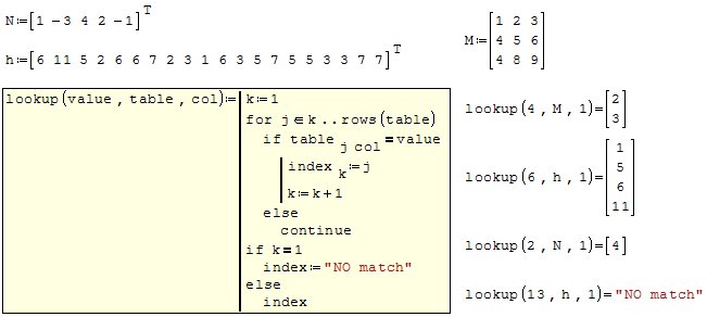

#5 Posted: 5/28/2020 1:53:56 AM
Alvaro Diaz Falconi
Alvaro Diaz Falconi
997 likes in 1676 posts.
Hi. Another couple of solutions.
problem.sm (13 KiB) downloaded 81 time(s).
