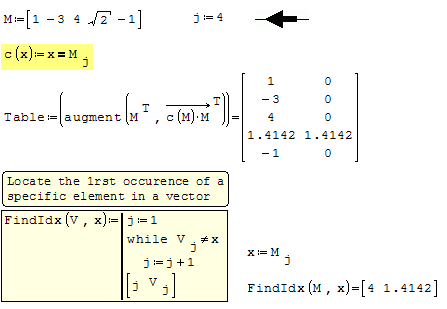

Also
(move the equal in the booleans from the leftmost addendum to the rightmost if you don't want to match zeros from the original vector as positive values)
frapuano 28.05.2020 05:09:00
#4 Опубликовано: 27.05.2020 21:56:07
Truth table in more general, multi purpose.
Utilities Matrix Truth Table [Locate row_col].sm (43,62 КиБ) скачан 841 раз(а).

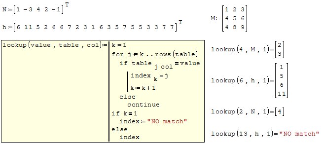

Hi. Another couple of solutions.
problem.sm (13,97 КиБ) скачан 1008 раз(а).
