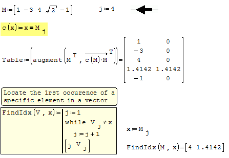

#3 Опубликовано: 27.05.2020 21:03:55
Also
(move the equal in the booleans from the leftmost addendum to the rightmost if you don't want to match zeros from the original vector as positive values)

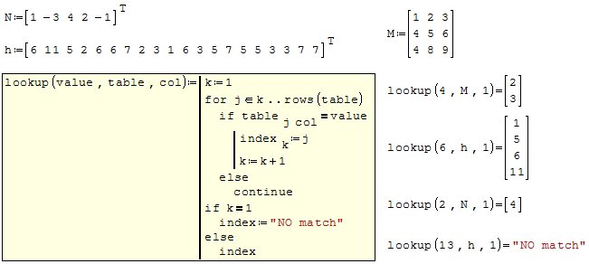

#4 Опубликовано: 27.05.2020 21:56:07
Truth table in more general, multi purpose.
Utilities Matrix Truth Table [Locate row_col].sm (43 КиБ) скачан 82 раз(а).
