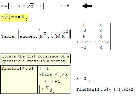

#4 Posted: 5/27/2020 9:56:07 PM
Truth table in more general, multi purpose.
Utilities Matrix Truth Table [Locate row_col].sm (43.62 KiB) downloaded 961 time(s).
frapuano 5/28/2020 5:09:00 AM

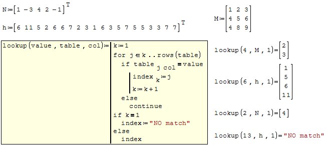

#5 Posted: 5/28/2020 1:53:56 AM
Hi. Another couple of solutions.
problem.sm (13.97 KiB) downloaded 1134 time(s).
frapuano 5/28/2020 5:09:00 AM, sergio 5/28/2020 5:33:00 AM
